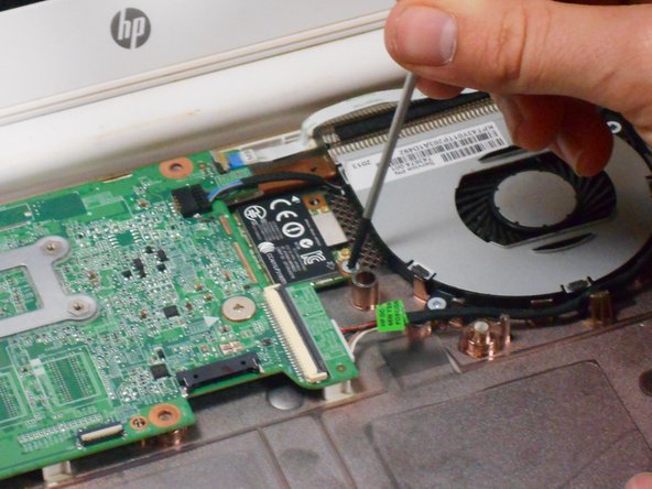

  6. HP Chromebook 14-Q010DX Bluetooth and Wireless Card Replacement, Bluetooth and Wireless Card: crwdns2935265:06crwdnd2935265:01crwdnd2935265:02crwdne2935265:0 HP Chromebook 14-Q010DX Bluetooth and Wireless Card Replacement, Bluetooth and Wireless Card: crwdns2935265:06crwdnd2935265:02crwdnd2935265:02crwdne2935265:0
    • Using a spudger, remove the white and black cables from the card.
  7. HP Chromebook 14-Q010DX Bluetooth and Wireless Card Replacement: crwdns2935265:07crwdnd2935265:01crwdnd2935265:02crwdne2935265:0 HP Chromebook 14-Q010DX Bluetooth and Wireless Card Replacement: crwdns2935265:07crwdnd2935265:02crwdnd2935265:02crwdne2935265:0
    • Remove screw from card.
  8. HP Chromebook 14-Q010DX Bluetooth and Wireless Card Replacement: crwdns2935265:08crwdnd2935265:01crwdnd2935265:01crwdne2935265:0
    • Gently pull card at a 45° angle to remove it.
