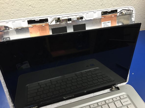

      • Once removed, we can proceed to remove (4) screws that hold the screen to the laptop case.
      • Marked in blue are the locations for the screws. Screws are closest to screen and on a light silver bracket. Pull screen forward and lay down on keyboard.

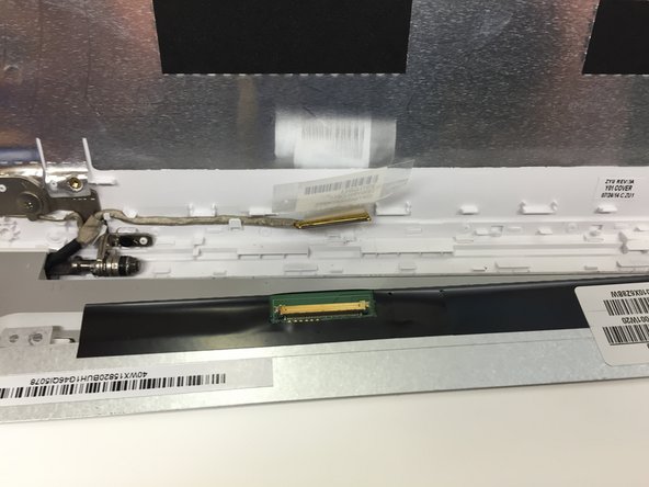

      • The ribbon cable is connected at the bottom of the screen. Tape is placed over the connection and it is easily peeled and easy to reuse. I would not advise cutting the tape.

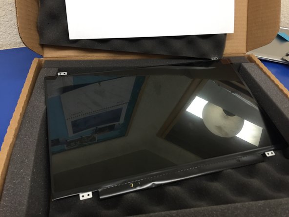

      • Connect your new screen and go backwards through the steps to install.
