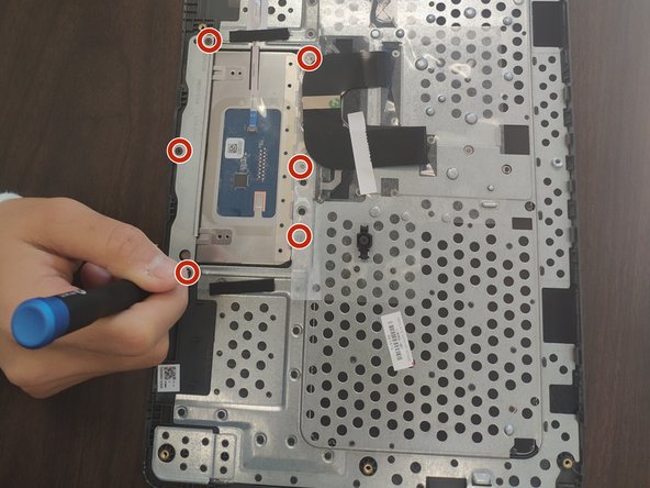

    • Remove the six screws over the touch board using the Phillips #00 screwdriver.
    • Remove the small protection piece of the touch board.

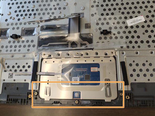

  4. HP Chromebook 14 G5 Touchpad Replacement: crwdns2935265:04crwdnd2935265:01crwdnd2935265:01crwdne2935265:0
    • Disconnect the FFC.
  5. HP Chromebook 14 G5 Touchpad Replacement: crwdns2935265:05crwdnd2935265:01crwdnd2935265:01crwdne2935265:0
    • Remove the trackpad from the device.
