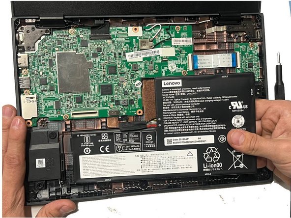

  8. HP Chromebook 14 G3 Battery Replacement: crwdns2935265:08crwdnd2935265:01crwdnd2935265:02crwdne2935265:0 HP Chromebook 14 G3 Battery Replacement: crwdns2935265:08crwdnd2935265:02crwdnd2935265:02crwdne2935265:0
    • Use tweezers to carefully detach the battery's cable connector from the motherboard.
    • Remove the screws holding the battery in place using a Phillips screwdriver.
    • Remove the battery.
