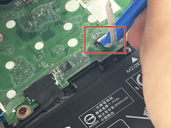

  6. HP Chromebook 11a-nb0013dx Speakers Replacement: crwdns2935265:06crwdnd2935265:01crwdnd2935265:02crwdne2935265:0 HP Chromebook 11a-nb0013dx Speakers Replacement: crwdns2935265:06crwdnd2935265:02crwdnd2935265:02crwdne2935265:0
    • Identify the second cable and the ZIF connector attatching the cable to the motherboard. Then, unclip it with the iFixit opening tool.
    • To do this, use the iFixit opening tool to flip up the small locking flap located on the ZIF connector.
    • Proceed by gently pulling the cable straight out of the connector to disconnect the cable.
    • Be careful, the cord is very fragile!

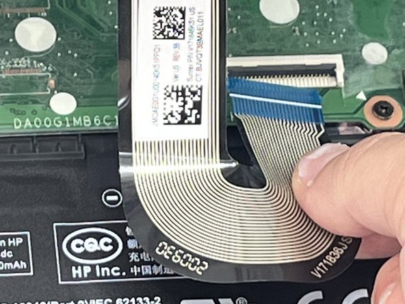

  7. HP Chromebook 11a-nb0013dx Speakers Replacement: crwdns2935265:07crwdnd2935265:01crwdnd2935265:01crwdne2935265:0
    • Once the white cord is removed, this is what it should look like. At this point, you should be able to completely take off the keyboard.
