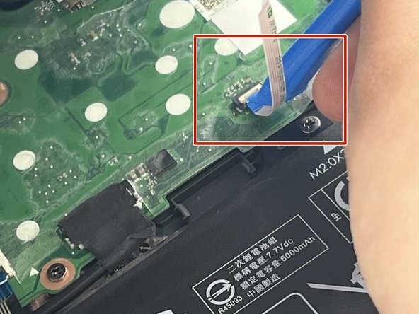

  4. HP Chromebook 11a-nb0013dx Motherboard Replacement: crwdns2935265:04crwdnd2935265:01crwdnd2935265:03crwdne2935265:0 HP Chromebook 11a-nb0013dx Motherboard Replacement: crwdns2935265:04crwdnd2935265:02crwdnd2935265:03crwdne2935265:0 HP Chromebook 11a-nb0013dx Motherboard Replacement: crwdns2935265:04crwdnd2935265:03crwdnd2935265:03crwdne2935265:0
    • Gentally lift up the keyboard and locate the two ribbons attatched to the motherboard.
    • Use the IFixit Opening Tool to lift the two tabs located on the zero insertion force (ZIF) connectors.
    • To do this, use the tip of the IFixit Opening Tool to flip up the small locking flap and gently pull the ribbon out.
    • Then, fully remove the keyboard and set aside.
