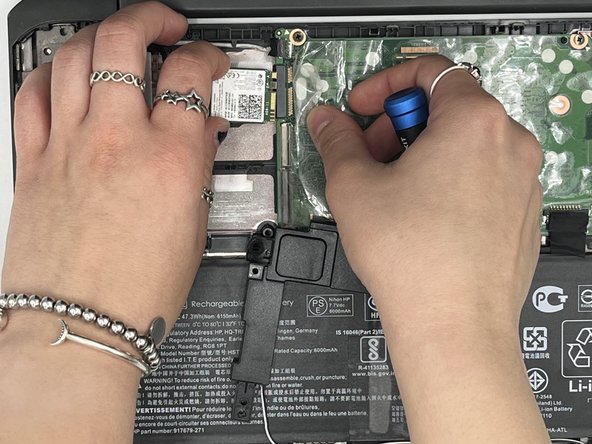

    • You do not need to remove the daughterboard or speakers to unplug the Wi-Fi chip like in the images
    • Locate the 4mm #0 Phillips screw securing the Wi-Fi chip in place.
    • Using a #0 Phillips screwdriver, unscrew the 4mm #0 Phillips screw holding the Wi-Fi chip into place and keep it in a safe place.
    • Once you have removed the screw that holds the Wi-Fi chip in place, gently unplug the Wi-Fi chip from the motherboard.
