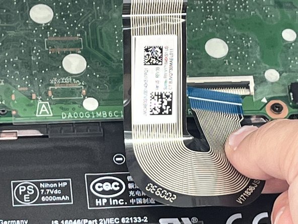

    • Identify the zero insertion force (ZIF) connector.
    • Now, disconnect the cable by using the tip of the iFixit opening tool or your fingernail to flip up the small locking flap.
    • You can now gently pull out the cable.
    • No force is needed to plug in or remove the cable.
  6. HP Chromebook 11a-nb0013dx Battery Replacement: crwdns2935265:06crwdnd2935265:01crwdnd2935265:02crwdne2935265:0 HP Chromebook 11a-nb0013dx Battery Replacement: crwdns2935265:06crwdnd2935265:02crwdnd2935265:02crwdne2935265:0

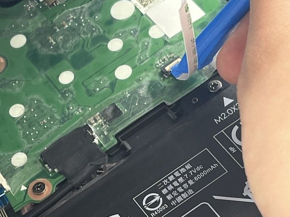

    • Identify the second cable and the ZIF connector attatching the cable to the motherboard. Then, unclip it with the iFixit opening tool.
    • To do this, use the iFixit opening tool to flip up the small locking flap located on the ZIF connector.
    • Proceed by gently pulling the cable straight out of the connector to disconnect the cable.
    • Be careful, the cord is very fragile!
  7. HP Chromebook 11a-nb0013dx Battery Replacement: crwdns2935265:07crwdnd2935265:01crwdnd2935265:01crwdne2935265:0
    • Once the white cord is removed, this is what it should look like. At this point, you should be able to completely take off the keyboard.

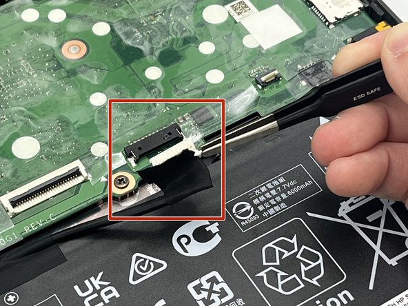

    • Lift up the adhesive holding the battery connector.
    • Then, pull the battery connector straight towards you.
    • It is important to pull of the battery connector straight towards you to avoid breaking the vord.

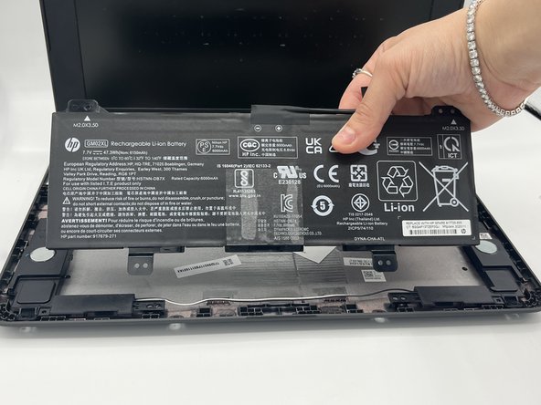

    • Remove the four 4 mm Philips #00 screws.
  10. HP Chromebook 11a-nb0013dx Battery Replacement: crwdns2935265:010crwdnd2935265:01crwdnd2935265:02crwdne2935265:0 HP Chromebook 11a-nb0013dx Battery Replacement: crwdns2935265:010crwdnd2935265:02crwdnd2935265:02crwdne2935265:0
    • Gently lift the battery by holding the top.
