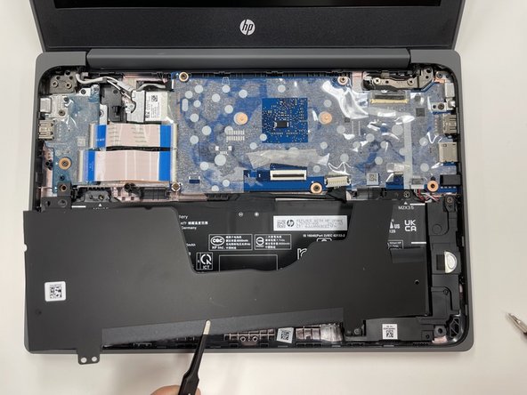

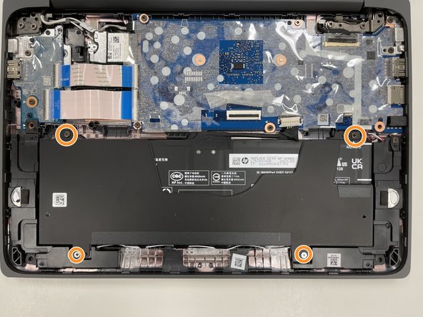

  4. HP Chromebook 11A G8 EE Speaker Replacement, Speaker: crwdns2935265:04crwdnd2935265:01crwdnd2935265:03crwdne2935265:0 HP Chromebook 11A G8 EE Speaker Replacement, Speaker: crwdns2935265:04crwdnd2935265:02crwdnd2935265:03crwdne2935265:0 HP Chromebook 11A G8 EE Speaker Replacement, Speaker: crwdns2935265:04crwdnd2935265:03crwdnd2935265:03crwdne2935265:0

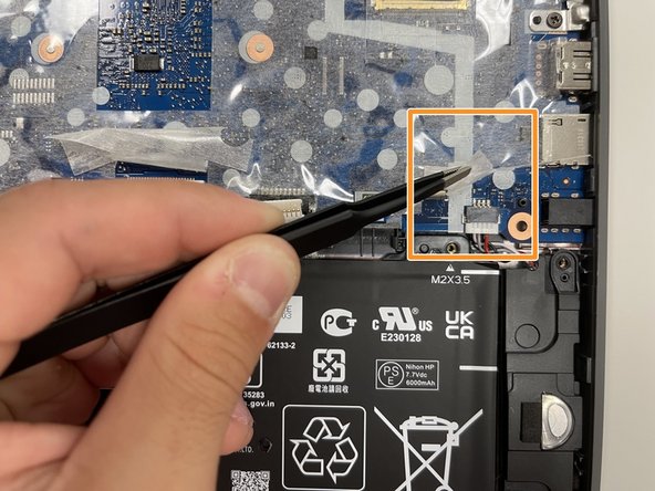

    • Using the tweezers, carefully disconnect the battery cable from the motherboard.
    • Use the Phillips #0 screwdriver, remove the four 3.5 mm screws that secure the battery cover to the battery.
    • Using the tweezers, carefully remove the battery cover.

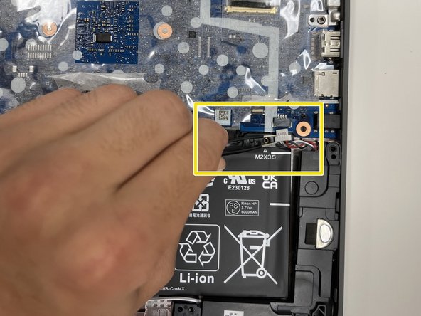

  5. HP Chromebook 11A G8 EE Speaker Replacement: crwdns2935265:05crwdnd2935265:01crwdnd2935265:03crwdne2935265:0 HP Chromebook 11A G8 EE Speaker Replacement: crwdns2935265:05crwdnd2935265:02crwdnd2935265:03crwdne2935265:0 HP Chromebook 11A G8 EE Speaker Replacement: crwdns2935265:05crwdnd2935265:03crwdnd2935265:03crwdne2935265:0
    • Using the Phillips #1 screwdriver, remove the 3.5 mm screw that secures the speaker to the frame.
    • Peel back the clear sheet.
    • Using the tweezers, carefully disconnect the speaker cable from the motherboard.

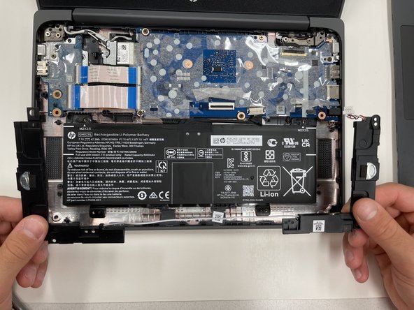

  6. HP Chromebook 11A G8 EE Speaker Replacement: crwdns2935265:06crwdnd2935265:01crwdnd2935265:02crwdne2935265:0 HP Chromebook 11A G8 EE Speaker Replacement: crwdns2935265:06crwdnd2935265:02crwdnd2935265:02crwdne2935265:0
    • Remove the speaker cable from the routing channel on the keyboard.
    • Using your hands, carefully lift the speakers out of the alignment pins, and remove.
