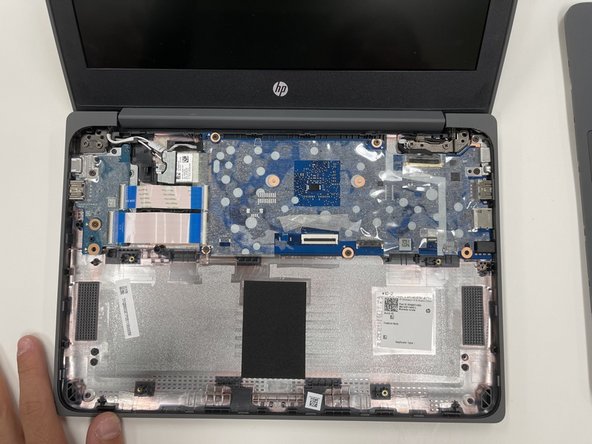

    • Flip the laptop over and open up the display.
    • Using the iFixit opening tool, carefully separate the palm rest from the bottom cover by working your way around the perimeter and prying it up.
    • You will hear an audible and tactile click or pop letting you know that you have unclipped a portion of the palm rest from the base enclosure.
    • Lift the palm rest of the laptops towards you, away from the screen.
  3. HP Chromebook 11A G8 EE Battery Replacement: crwdns2935265:03crwdnd2935265:01crwdnd2935265:02crwdne2935265:0 HP Chromebook 11A G8 EE Battery Replacement: crwdns2935265:03crwdnd2935265:02crwdnd2935265:02crwdne2935265:0
    • Carefully, lift the keyboard ribbon lock and disconnect the keyboard ribbon from the motherboard.
    • Disconnect the touchpad ribbon from the motherboard, and remove top cover.
    • Remove the keyboard.
