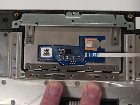

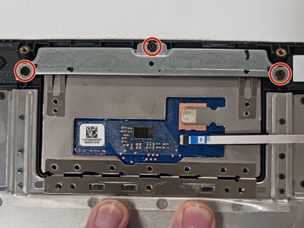

  5. HP Chromebook 11A G6 EE Touchpad Replacement: crwdns2935265:05crwdnd2935265:01crwdnd2935265:03crwdne2935265:0 HP Chromebook 11A G6 EE Touchpad Replacement: crwdns2935265:05crwdnd2935265:02crwdnd2935265:03crwdne2935265:0 HP Chromebook 11A G6 EE Touchpad Replacement: crwdns2935265:05crwdnd2935265:03crwdnd2935265:03crwdne2935265:0
    • Remove the three 2.5 mm screws that secure the touchpad and touchpad bracket to the keyboard/top cover using a Phillips #1 screwdriver.
    • Remove the three 2.0 mm screws that secure the touchpad to the keyboard/top cover using a Phillips #1 screwdriver.
  6. HP Chromebook 11A G6 EE Touchpad Replacement: crwdns2935265:06crwdnd2935265:01crwdnd2935265:03crwdne2935265:0 HP Chromebook 11A G6 EE Touchpad Replacement: crwdns2935265:06crwdnd2935265:02crwdnd2935265:03crwdne2935265:0 HP Chromebook 11A G6 EE Touchpad Replacement: crwdns2935265:06crwdnd2935265:03crwdnd2935265:03crwdne2935265:0
    • Using a spudger, remove the touchpad bracket.
    • Push up on the touchpad from the keyboard side and remove the touchpad.
