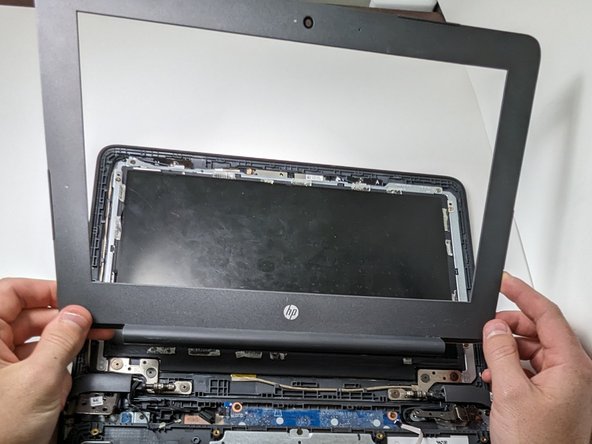

  4. HP Chromebook 11A G6 EE LCD Replacement, LCD: crwdns2935265:04crwdnd2935265:01crwdnd2935265:02crwdne2935265:0 HP Chromebook 11A G6 EE LCD Replacement, LCD: crwdns2935265:04crwdnd2935265:02crwdnd2935265:02crwdne2935265:0
    • Using your iFixit opening tool, ease it in between the frame of the top case and lift up.
    • Slide your opening tool clockwise around the edge of the laptop, separating the front panel from the top case.
    • Lay the laptop flat.
    • Carefully lift the frame and bring the top of the top cover towards you.
    • There will be adhesive connecting the frame to the LCD display.
    • Once the frame is about 90 degrees from the base, pull the bottom of the frame towards you, separating the frame from the top case.

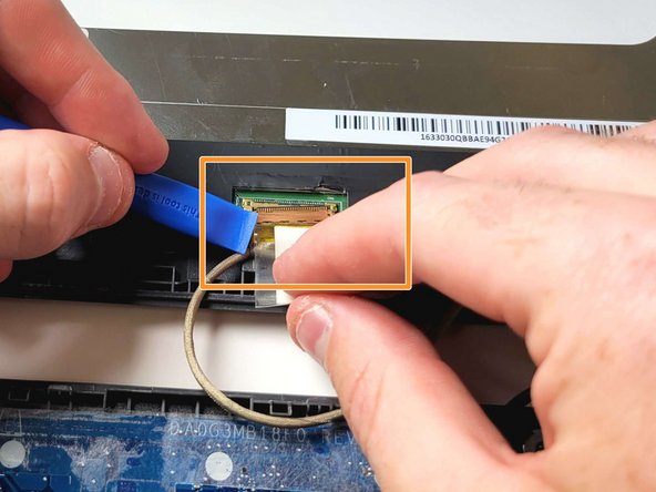

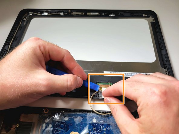

  7. HP Chromebook 11A G6 EE LCD Replacement: crwdns2935265:07crwdnd2935265:01crwdnd2935265:03crwdne2935265:0 HP Chromebook 11A G6 EE LCD Replacement: crwdns2935265:07crwdnd2935265:02crwdnd2935265:03crwdne2935265:0 HP Chromebook 11A G6 EE LCD Replacement: crwdns2935265:07crwdnd2935265:03crwdnd2935265:03crwdne2935265:0
    • Lift the display out of its setting and turn it over.
    • When installing your new LCD screen, set the face of the screen on a soft or flat surface and not in the top case where it could be scratched.
    • Locate the LCD cable connection at the bottom of the display and peel back the tape connecting the cable.
    • Using your iFixit opening tool, put the corner of the tool into the small gap in the corner where the connection is made and pry it back towards you.
    • Do not pull the individual wires out of the termination. This will cause severe damage to your LCD Display connector and you will have to replace the cable.
