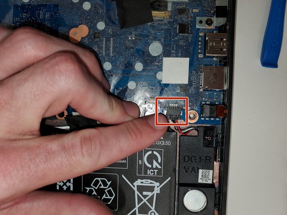

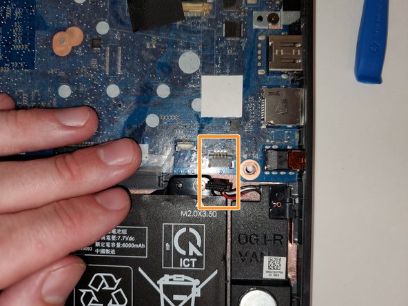

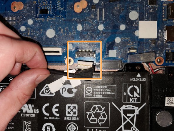

  4. HP Chromebook 11A G6 EE Battery Replacement, Speakers: crwdns2935265:04crwdnd2935265:01crwdnd2935265:03crwdne2935265:0 HP Chromebook 11A G6 EE Battery Replacement, Speakers: crwdns2935265:04crwdnd2935265:02crwdnd2935265:03crwdne2935265:0 HP Chromebook 11A G6 EE Battery Replacement, Speakers: crwdns2935265:04crwdnd2935265:03crwdnd2935265:03crwdne2935265:0
    • Release the tape that secures the battery cable connector to the system board.
    • Disconnect the battery cable from the system board. Pull the cable straight out of the connector by the white plastic portion near the connection point.
    • Don't pull the cable out by the wire or it may become damaged.

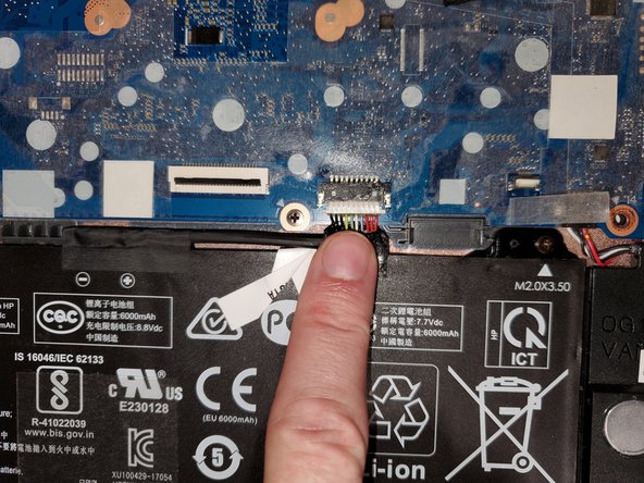

  5. HP Chromebook 11A G6 EE Battery Replacement: crwdns2935265:05crwdnd2935265:01crwdnd2935265:03crwdne2935265:0 HP Chromebook 11A G6 EE Battery Replacement: crwdns2935265:05crwdnd2935265:02crwdnd2935265:03crwdne2935265:0 HP Chromebook 11A G6 EE Battery Replacement: crwdns2935265:05crwdnd2935265:03crwdnd2935265:03crwdne2935265:0
    • Peel the tape off of the speaker cable connector.
    • Disconnect the speaker cable from the system board. Pull the cable straight out of the connector by the black plastic portion near the connection point. Disconnect the speaker cable from the system board.
    • To avoid damage, don't pull on the wires.

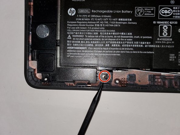

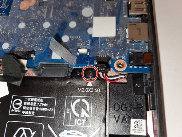

  7. HP Chromebook 11A G6 EE Battery Replacement, Battery: crwdns2935265:07crwdnd2935265:01crwdnd2935265:02crwdne2935265:0 HP Chromebook 11A G6 EE Battery Replacement, Battery: crwdns2935265:07crwdnd2935265:02crwdnd2935265:02crwdne2935265:0
    • Remove the two 3.5 mm screws at the top of the battery using a Phillips #1 screwdriver.

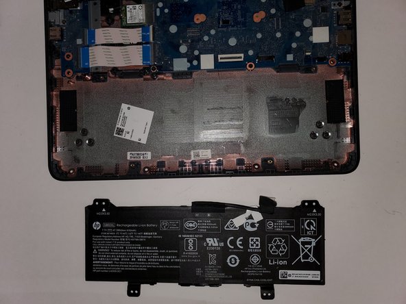

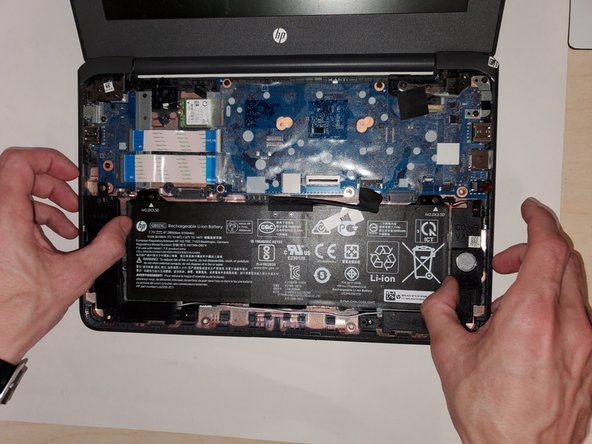

  8. HP Chromebook 11A G6 EE Battery Replacement: crwdns2935265:08crwdnd2935265:01crwdnd2935265:02crwdne2935265:0 HP Chromebook 11A G6 EE Battery Replacement: crwdns2935265:08crwdnd2935265:02crwdnd2935265:02crwdne2935265:0
    • Lift out and remove the battery.
