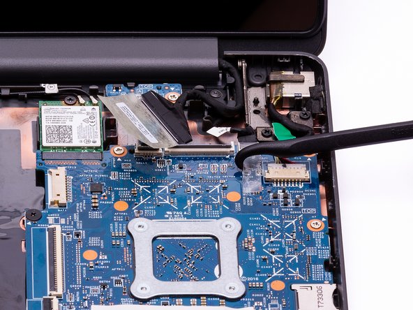

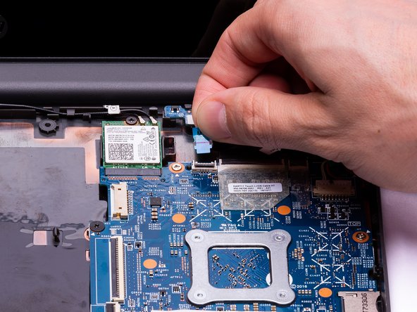

    • Using the hook on the halberd spudger, gently lift up the ZIF connector tab that connects the Hall Sensor Board ribbon cable to the Motherboard.
  19. HP Chromebook 11-v019wm Touch Display Replacement: crwdns2935265:019crwdnd2935265:01crwdnd2935265:03crwdne2935265:0 HP Chromebook 11-v019wm Touch Display Replacement: crwdns2935265:019crwdnd2935265:02crwdnd2935265:03crwdne2935265:0 HP Chromebook 11-v019wm Touch Display Replacement: crwdns2935265:019crwdnd2935265:03crwdnd2935265:03crwdne2935265:0
    • With the ZIF connector tab in the upright position, gently pinch the blue lifting tab and remove the Hall Sensor ribbon cable from the ZIF connector.

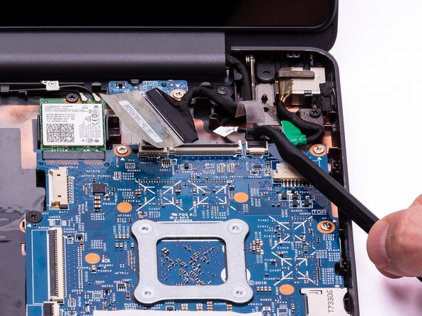

  20. HP Chromebook 11-v019wm Touch Display Replacement: crwdns2935265:020crwdnd2935265:01crwdnd2935265:03crwdne2935265:0 HP Chromebook 11-v019wm Touch Display Replacement: crwdns2935265:020crwdnd2935265:02crwdnd2935265:03crwdne2935265:0 HP Chromebook 11-v019wm Touch Display Replacement: crwdns2935265:020crwdnd2935265:03crwdnd2935265:03crwdne2935265:0

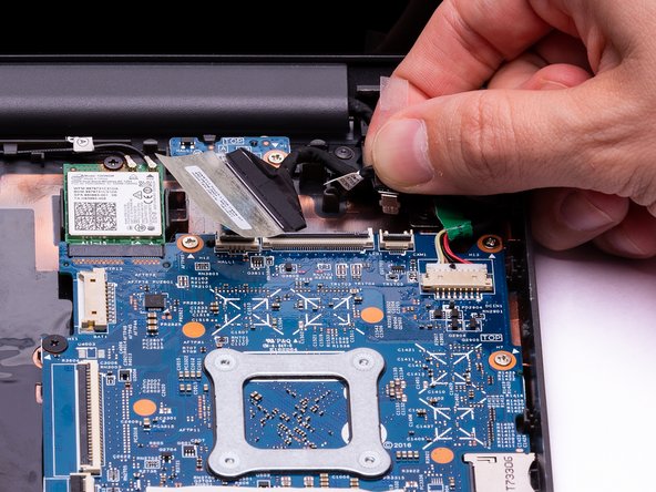

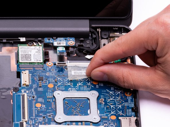

    • Using your fingers or the hook on the halberd spudger, gently lift up the clear plastic sticker to reveal the ZIF connector securing the LVDS Touch Display to the Motherboard.
    • This step is only performed to gain access to the Touch Display ZIF connector. Not all Chromebook's may have this plastic sticker covering the ZIF Connector. If there is no plastic sticker, this step may be skipped.

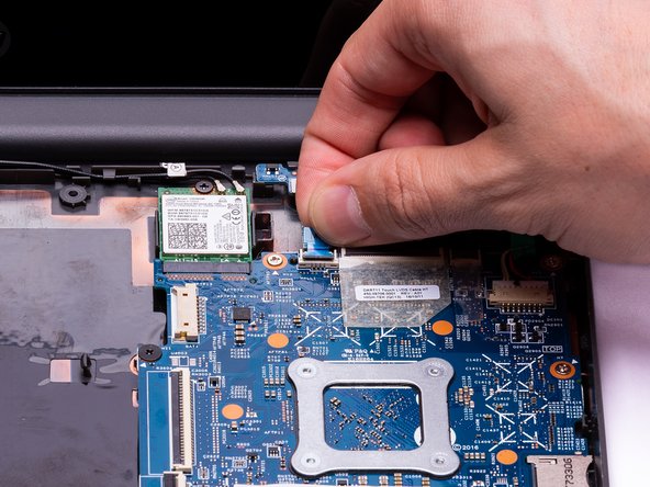

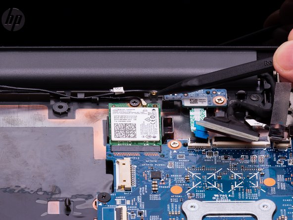

  21. HP Chromebook 11-v019wm Touch Display Replacement: crwdns2935265:021crwdnd2935265:01crwdnd2935265:02crwdne2935265:0 HP Chromebook 11-v019wm Touch Display Replacement: crwdns2935265:021crwdnd2935265:02crwdnd2935265:02crwdne2935265:0

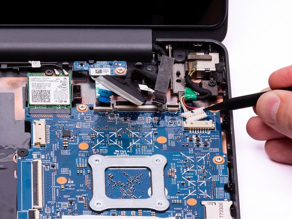

    • Using the hook on the halberd spudger, gently lift the ZIF connector tab securing the Touch Display LVDS cable to the Motherboard.
  22. HP Chromebook 11-v019wm Touch Display Replacement: crwdns2935265:022crwdnd2935265:01crwdnd2935265:03crwdne2935265:0 HP Chromebook 11-v019wm Touch Display Replacement: crwdns2935265:022crwdnd2935265:02crwdnd2935265:03crwdne2935265:0 HP Chromebook 11-v019wm Touch Display Replacement: crwdns2935265:022crwdnd2935265:03crwdnd2935265:03crwdne2935265:0
    • With the ZIF connector tab in the upright position, gently remove the Touch Display LVDS cable from the ZIF connector.
  23. HP Chromebook 11-v019wm Touch Display Replacement: crwdns2935265:023crwdnd2935265:01crwdnd2935265:03crwdne2935265:0 HP Chromebook 11-v019wm Touch Display Replacement: crwdns2935265:023crwdnd2935265:02crwdnd2935265:03crwdne2935265:0 HP Chromebook 11-v019wm Touch Display Replacement: crwdns2935265:023crwdnd2935265:03crwdnd2935265:03crwdne2935265:0

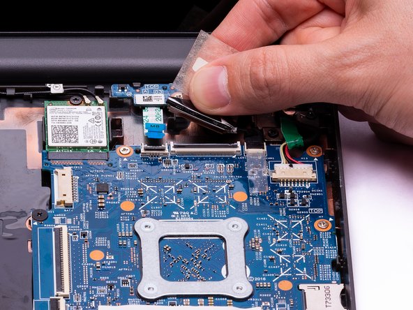

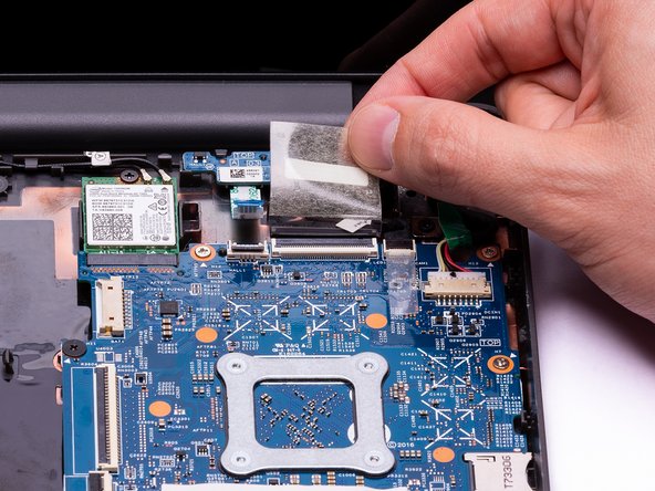

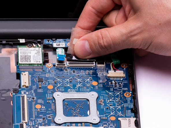

    • Using your fingers or the hook on the halberd spudger, gently lift up on the plastic sticker to reveal the Webcam ZIF connector.
    • This step is only performed to gain access to the Webcam ZIF connector. Not all Chromebook's may have this plastic sticker covering the ZIF connector. If there is no plastic sticker, this step may be skipped.

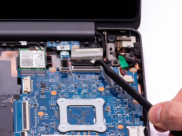

  24. HP Chromebook 11-v019wm Touch Display Replacement: crwdns2935265:024crwdnd2935265:01crwdnd2935265:03crwdne2935265:0 HP Chromebook 11-v019wm Touch Display Replacement: crwdns2935265:024crwdnd2935265:02crwdnd2935265:03crwdne2935265:0 HP Chromebook 11-v019wm Touch Display Replacement: crwdns2935265:024crwdnd2935265:03crwdnd2935265:03crwdne2935265:0
    • Using the hook on the halberd spudger, gently lift the Webcam ZIF connector tab.
  25. HP Chromebook 11-v019wm Touch Display Replacement: crwdns2935265:025crwdnd2935265:01crwdnd2935265:02crwdne2935265:0 HP Chromebook 11-v019wm Touch Display Replacement: crwdns2935265:025crwdnd2935265:02crwdnd2935265:02crwdne2935265:0
    • With the Webcam ZIF connector tab in the upright position, gently pinch the black lifting tab and remove the connector from the ZIF connector on the motherboard.

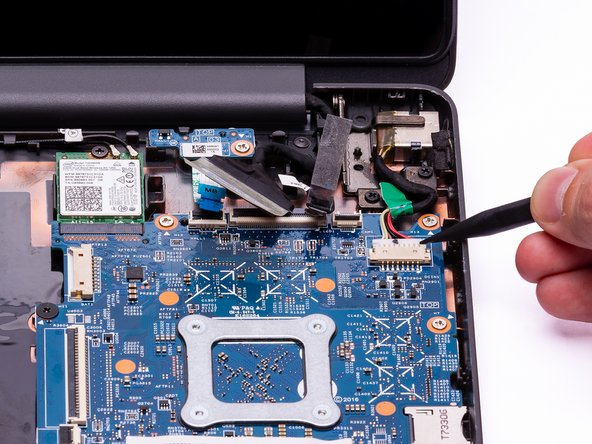

  26. HP Chromebook 11-v019wm Touch Display Replacement: crwdns2935265:026crwdnd2935265:01crwdnd2935265:03crwdne2935265:0 HP Chromebook 11-v019wm Touch Display Replacement: crwdns2935265:026crwdnd2935265:02crwdnd2935265:03crwdne2935265:0 HP Chromebook 11-v019wm Touch Display Replacement: crwdns2935265:026crwdnd2935265:03crwdnd2935265:03crwdne2935265:0

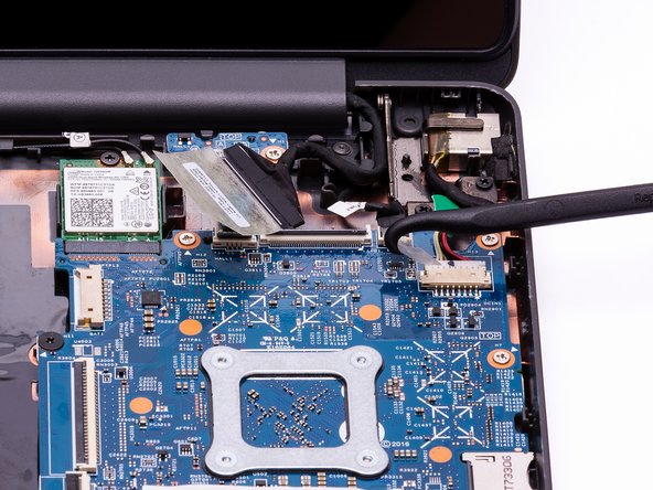

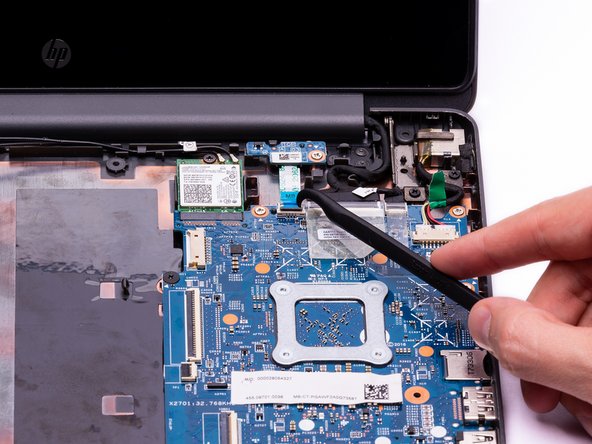

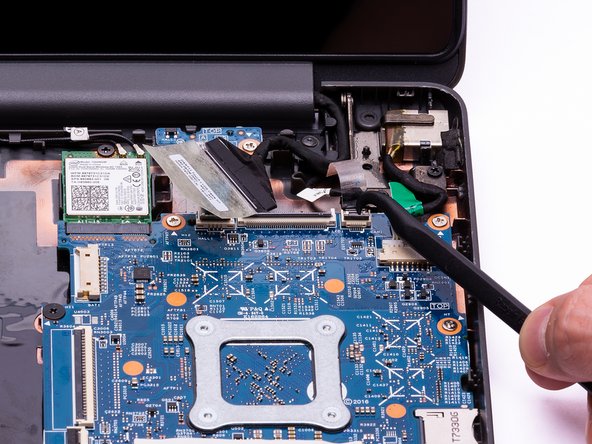

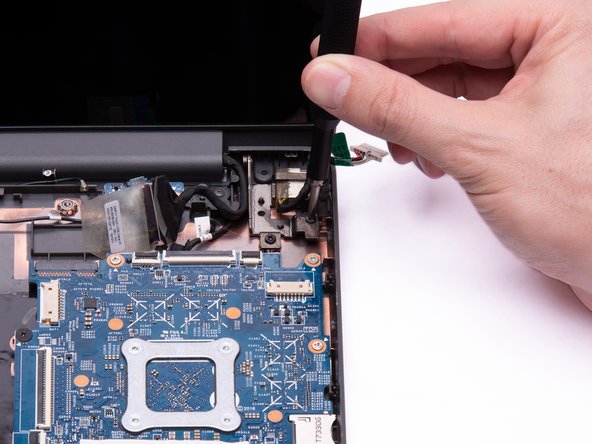

    • With either end of the spudger, remove the charging port cable from the bundle connector on the motherboard.
    • If the connector does not move when pushing on one side, push the other side to evenly remove the connector.

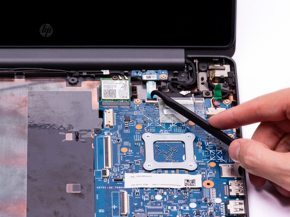

  27. HP Chromebook 11-v019wm Touch Display Replacement: crwdns2935265:027crwdnd2935265:01crwdnd2935265:03crwdne2935265:0 HP Chromebook 11-v019wm Touch Display Replacement: crwdns2935265:027crwdnd2935265:02crwdnd2935265:03crwdne2935265:0 HP Chromebook 11-v019wm Touch Display Replacement: crwdns2935265:027crwdnd2935265:03crwdnd2935265:03crwdne2935265:0

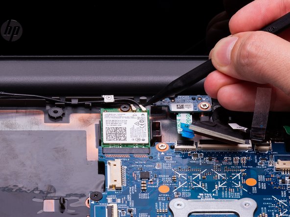

    • Using the fine point of the spudger, gently lift up the (2) antenna coaxial connectors on the WLAN module.
    • The (2) antenna cables run along the top of the Chromebook casing and are attached to the Touch Display. Make sure the antenna cables are removed from their routing tabs to avoid damaging the cables.

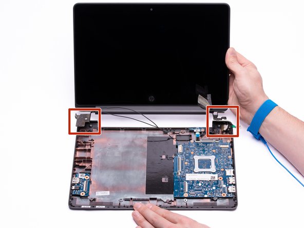

  28. HP Chromebook 11-v019wm Touch Display Replacement: crwdns2935265:028crwdnd2935265:01crwdnd2935265:02crwdne2935265:0 HP Chromebook 11-v019wm Touch Display Replacement: crwdns2935265:028crwdnd2935265:02crwdnd2935265:02crwdne2935265:0
    • Using the Phillips #00 Screwdriver, remove the (4) 4.6mm screws from the left and right mounting brackets.
    • The mounting brackets secure the touch display to the base of the Chromebook. Use one hand to support the display before removing the final screw to ensure the display doesn't fall backwards after the screws have been removed.
  29. HP Chromebook 11-v019wm Touch Display Replacement: crwdns2935265:029crwdnd2935265:01crwdnd2935265:02crwdne2935265:0 HP Chromebook 11-v019wm Touch Display Replacement: crwdns2935265:029crwdnd2935265:02crwdnd2935265:02crwdne2935265:0
    • With one hand holding the base of the Chromebook, use the other hand to lift the display away from the base.
    • This step may require the display to be slightly compressed forward so the display mounts can clear the back of the base.
