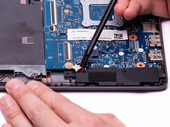

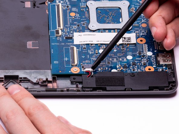

    • Using either side of the spudger, disconnect the speaker cable from the bundle connector located on the bottom of the motherboard.

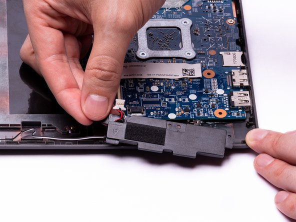

  19. HP Chromebook 11-v019wm Speaker Replacement: crwdns2935265:019crwdnd2935265:01crwdnd2935265:02crwdne2935265:0 HP Chromebook 11-v019wm Speaker Replacement: crwdns2935265:019crwdnd2935265:02crwdnd2935265:02crwdne2935265:0

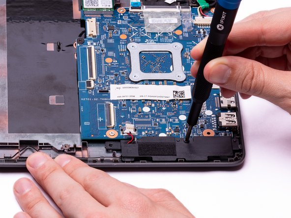

    • Using a Phillips #00 screwdriver, remove the 4.8 mm screw that secures the right speaker to the Chromebook housing.
    • The 4.8mm screw securing the left speaker was removed during the removal of the Chromebook's battery.
  20. HP Chromebook 11-v019wm Speaker Replacement: crwdns2935265:020crwdnd2935265:01crwdnd2935265:03crwdne2935265:0 HP Chromebook 11-v019wm Speaker Replacement: crwdns2935265:020crwdnd2935265:02crwdnd2935265:03crwdne2935265:0 HP Chromebook 11-v019wm Speaker Replacement: crwdns2935265:020crwdnd2935265:03crwdnd2935265:03crwdne2935265:0

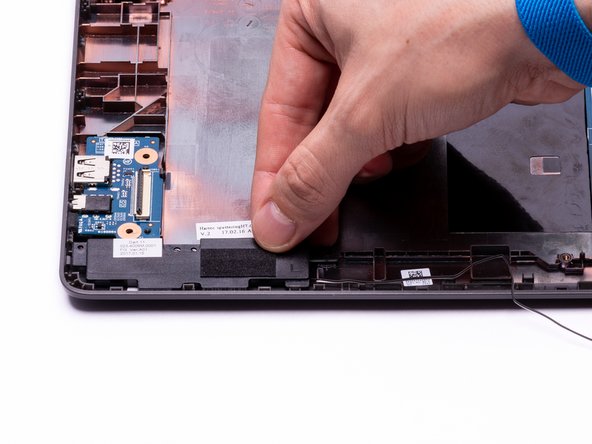

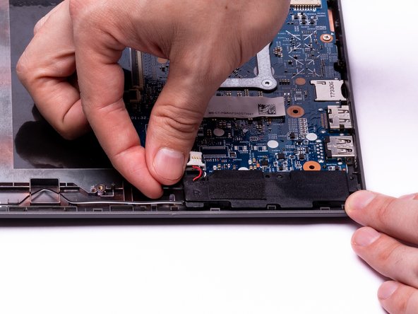

    • Gently remove the right speaker from the computer assembly.
    • The cable connecting the left and right speaker is very thin and runs along a series of small clips. During removal and installation, guide the cable through these clips and avoid pulling too hard on the cable.

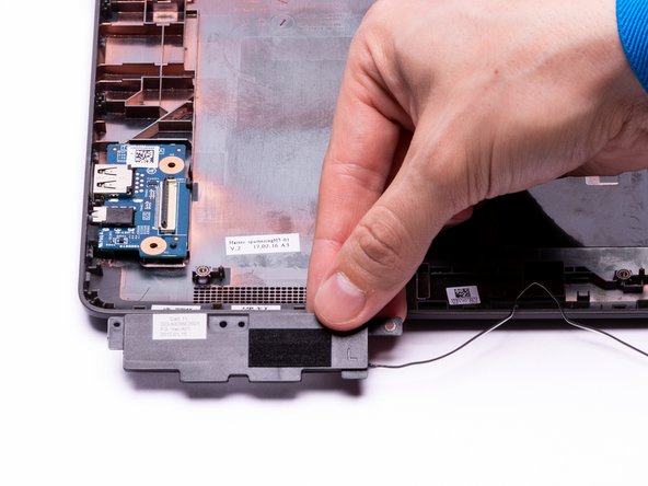

    • Gently remove the left speaker from the computer assembly.
