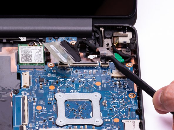

  23. HP Chromebook 11-v019wm Motherboard Replacement, Motherboard: crwdns2935265:023crwdnd2935265:01crwdnd2935265:03crwdne2935265:0 HP Chromebook 11-v019wm Motherboard Replacement, Motherboard: crwdns2935265:023crwdnd2935265:02crwdnd2935265:03crwdne2935265:0 HP Chromebook 11-v019wm Motherboard Replacement, Motherboard: crwdns2935265:023crwdnd2935265:03crwdnd2935265:03crwdne2935265:0
    Halberd Spudger
    $2.99

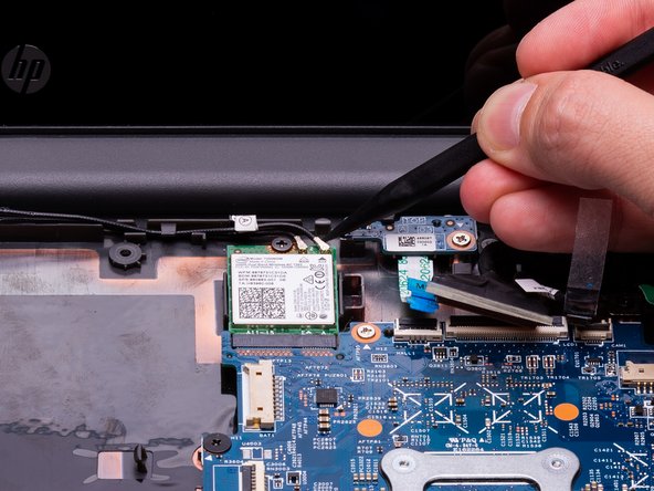

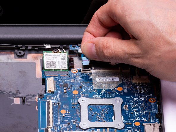

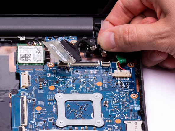

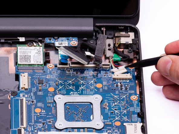

    • Using the hook on the halberd spudger, gently lift up the ZIF connector tab that connects the Hall Sensor Board ribbon cable to the Motherboard.
  24. HP Chromebook 11-v019wm Motherboard Replacement: crwdns2935265:024crwdnd2935265:01crwdnd2935265:03crwdne2935265:0 HP Chromebook 11-v019wm Motherboard Replacement: crwdns2935265:024crwdnd2935265:02crwdnd2935265:03crwdne2935265:0 HP Chromebook 11-v019wm Motherboard Replacement: crwdns2935265:024crwdnd2935265:03crwdnd2935265:03crwdne2935265:0
    • With the ZIF connector tab in the upright position, gently pinch the blue lifting tab and remove the Hall Sensor ribbon cable from the ZIF connector.
  25. HP Chromebook 11-v019wm Motherboard Replacement: crwdns2935265:025crwdnd2935265:01crwdnd2935265:03crwdne2935265:0 HP Chromebook 11-v019wm Motherboard Replacement: crwdns2935265:025crwdnd2935265:02crwdnd2935265:03crwdne2935265:0 HP Chromebook 11-v019wm Motherboard Replacement: crwdns2935265:025crwdnd2935265:03crwdnd2935265:03crwdne2935265:0

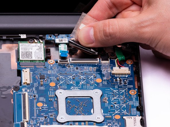

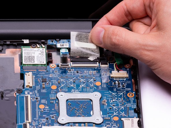

    • Using your fingers or the hook on the halberd spudger, gently lift up the clear plastic sticker to reveal the ZIF connector securing the LVDS Touch Display to the Motherboard.
    • This step is only performed to gain access to the Touch Display ZIF connector. Not all Chromebook's may have this plastic sticker covering the ZIF Connector. If there is no plastic sticker, this step may be skipped.

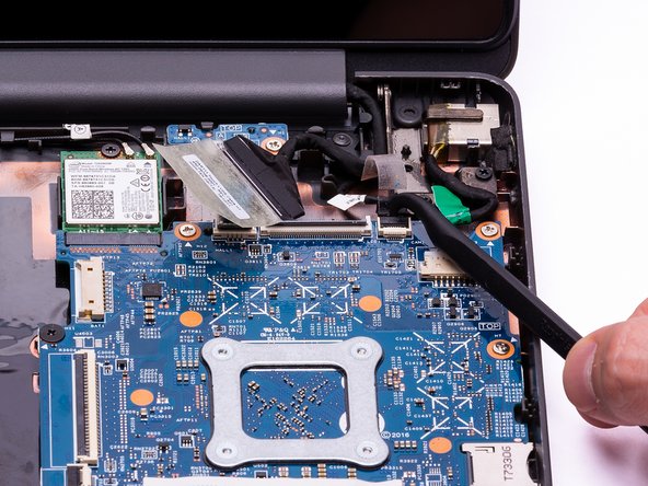

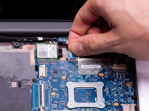

  26. HP Chromebook 11-v019wm Motherboard Replacement: crwdns2935265:026crwdnd2935265:01crwdnd2935265:02crwdne2935265:0 HP Chromebook 11-v019wm Motherboard Replacement: crwdns2935265:026crwdnd2935265:02crwdnd2935265:02crwdne2935265:0

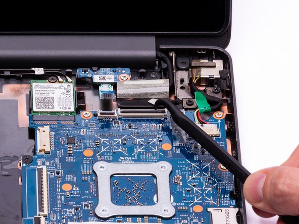

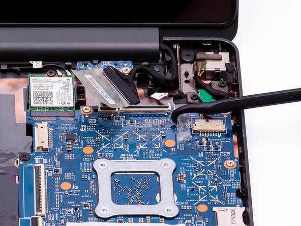

    • Using the hook on the halberd spudger, gently lift the ZIF connector tab securing the Touch Display LVDS cable to the Motherboard.
  27. HP Chromebook 11-v019wm Motherboard Replacement: crwdns2935265:027crwdnd2935265:01crwdnd2935265:03crwdne2935265:0 HP Chromebook 11-v019wm Motherboard Replacement: crwdns2935265:027crwdnd2935265:02crwdnd2935265:03crwdne2935265:0 HP Chromebook 11-v019wm Motherboard Replacement: crwdns2935265:027crwdnd2935265:03crwdnd2935265:03crwdne2935265:0
    • With the ZIF connector tab in the upright position, gently remove the Touch Display LVDS cable from the ZIF connector.
  28. HP Chromebook 11-v019wm Motherboard Replacement: crwdns2935265:028crwdnd2935265:01crwdnd2935265:03crwdne2935265:0 HP Chromebook 11-v019wm Motherboard Replacement: crwdns2935265:028crwdnd2935265:02crwdnd2935265:03crwdne2935265:0 HP Chromebook 11-v019wm Motherboard Replacement: crwdns2935265:028crwdnd2935265:03crwdnd2935265:03crwdne2935265:0

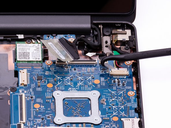

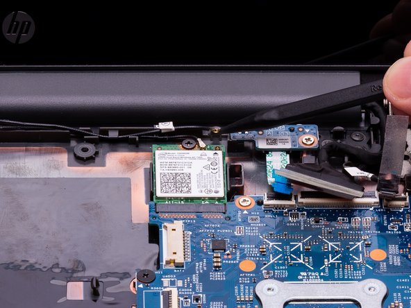

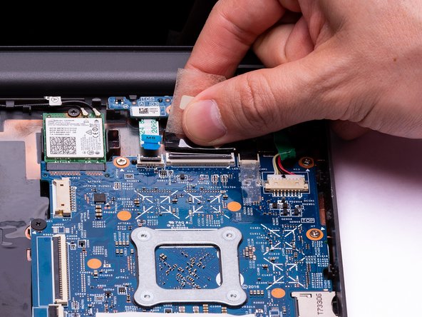

    • Using your fingers or the hook on the halberd spudger, gently lift up on the plastic sticker to reveal the Webcam ZIF connector.
    • This step is only performed to gain access to the Webcam ZIF connector. Not all Chromebook's may have this plastic sticker covering the ZIF connector. If there is no plastic sticker, this step may be skipped.
  29. HP Chromebook 11-v019wm Motherboard Replacement: crwdns2935265:029crwdnd2935265:01crwdnd2935265:03crwdne2935265:0 HP Chromebook 11-v019wm Motherboard Replacement: crwdns2935265:029crwdnd2935265:02crwdnd2935265:03crwdne2935265:0 HP Chromebook 11-v019wm Motherboard Replacement: crwdns2935265:029crwdnd2935265:03crwdnd2935265:03crwdne2935265:0
    • Using the hook on the halberd spudger, gently lift the Webcam ZIF connector tab.
  30. HP Chromebook 11-v019wm Motherboard Replacement: crwdns2935265:030crwdnd2935265:01crwdnd2935265:02crwdne2935265:0 HP Chromebook 11-v019wm Motherboard Replacement: crwdns2935265:030crwdnd2935265:02crwdnd2935265:02crwdne2935265:0
    • With the Webcam ZIF connector tab in the upright position, gently pinch the black lifting tab and remove the connector from the ZIF connector on the motherboard.
  31. HP Chromebook 11-v019wm Motherboard Replacement: crwdns2935265:031crwdnd2935265:01crwdnd2935265:03crwdne2935265:0 HP Chromebook 11-v019wm Motherboard Replacement: crwdns2935265:031crwdnd2935265:02crwdnd2935265:03crwdne2935265:0 HP Chromebook 11-v019wm Motherboard Replacement: crwdns2935265:031crwdnd2935265:03crwdnd2935265:03crwdne2935265:0

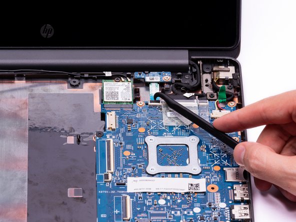

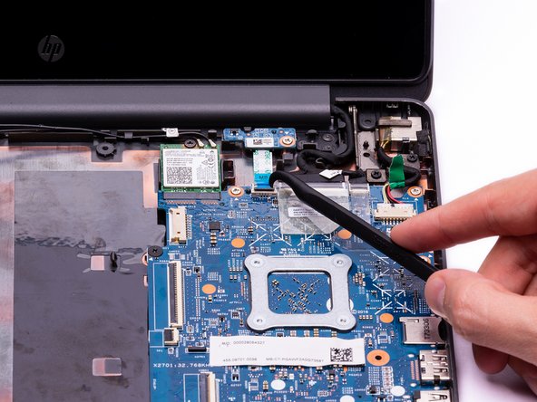

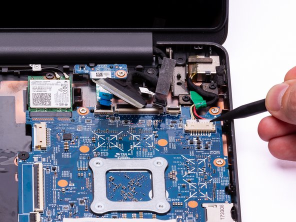

    • With either end of the spudger, remove the charging port cable from the bundle connector on the motherboard.
    • If the connector does not move when pushing on one side, push the other side to evenly remove the connector.
  32. HP Chromebook 11-v019wm Motherboard Replacement: crwdns2935265:032crwdnd2935265:01crwdnd2935265:03crwdne2935265:0 HP Chromebook 11-v019wm Motherboard Replacement: crwdns2935265:032crwdnd2935265:02crwdnd2935265:03crwdne2935265:0 HP Chromebook 11-v019wm Motherboard Replacement: crwdns2935265:032crwdnd2935265:03crwdnd2935265:03crwdne2935265:0

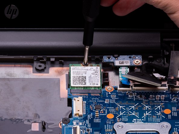

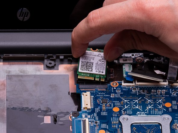

  33. HP Chromebook 11-v019wm Motherboard Replacement: crwdns2935265:033crwdnd2935265:01crwdnd2935265:02crwdne2935265:0 HP Chromebook 11-v019wm Motherboard Replacement: crwdns2935265:033crwdnd2935265:02crwdnd2935265:02crwdne2935265:0
    • Using a Phillips #00 Screwdriver, remove the 3.5mm screw from the WLAN module.

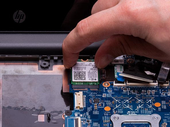

  34. HP Chromebook 11-v019wm Motherboard Replacement: crwdns2935265:034crwdnd2935265:01crwdnd2935265:03crwdne2935265:0 HP Chromebook 11-v019wm Motherboard Replacement: crwdns2935265:034crwdnd2935265:02crwdnd2935265:03crwdne2935265:0 HP Chromebook 11-v019wm Motherboard Replacement: crwdns2935265:034crwdnd2935265:03crwdnd2935265:03crwdne2935265:0
    • Gently lift and slide the WLAN module out of the WLAN connector on the top of the motherboard.
  35. HP Chromebook 11-v019wm Motherboard Replacement: crwdns2935265:035crwdnd2935265:01crwdnd2935265:02crwdne2935265:0 HP Chromebook 11-v019wm Motherboard Replacement: crwdns2935265:035crwdnd2935265:02crwdnd2935265:02crwdne2935265:0

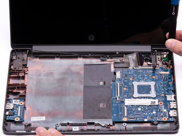

    • Using a Phillips #00 Screwdriver, remove the (4) 3.3mm screws from the motherboard.
    • Using a Phillips #00 Screwdriver, remove the 3.5mm screw from the motherboard.

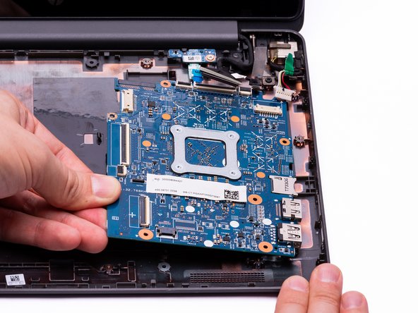

  36. HP Chromebook 11-v019wm Motherboard Replacement: crwdns2935265:036crwdnd2935265:01crwdnd2935265:02crwdne2935265:0 HP Chromebook 11-v019wm Motherboard Replacement: crwdns2935265:036crwdnd2935265:02crwdnd2935265:02crwdne2935265:0
    • Gently lift and pull the motherboard towards the center of the base to remove it from the computer assembly.
