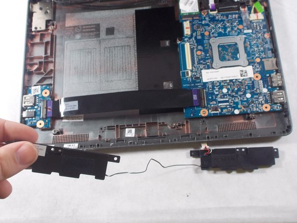

  9. HP Chromebook 11-v011dx Speaker  Replacement, Speaker: crwdns2935265:09crwdnd2935265:01crwdnd2935265:02crwdne2935265:0 HP Chromebook 11-v011dx Speaker  Replacement, Speaker: crwdns2935265:09crwdnd2935265:02crwdnd2935265:02crwdne2935265:0
    • Use a Phillips #0 screwdriver to remove the one 1.3mm screw that connects the speakers and the motherboard together.
  10. HP Chromebook 11-v011dx Speaker  Replacement: crwdns2935265:010crwdnd2935265:01crwdnd2935265:01crwdne2935265:0
    • Make sure to hold the white part of the plug and not the wire. If unplugged by holding the wires, it can rip out wires.
    • Slowly and cautiously unplug the wire that connects the speakers to the motherboard with your hands.
  11. HP Chromebook 11-v011dx Speaker  Replacement: crwdns2935265:011crwdnd2935265:01crwdnd2935265:02crwdne2935265:0 HP Chromebook 11-v011dx Speaker  Replacement: crwdns2935265:011crwdnd2935265:02crwdnd2935265:02crwdne2935265:0
    • Be careful with the wire between both end of the speakers. It's between metal parts and can get caught.
    • Slowly remove both ends of the speakers with your hands.
