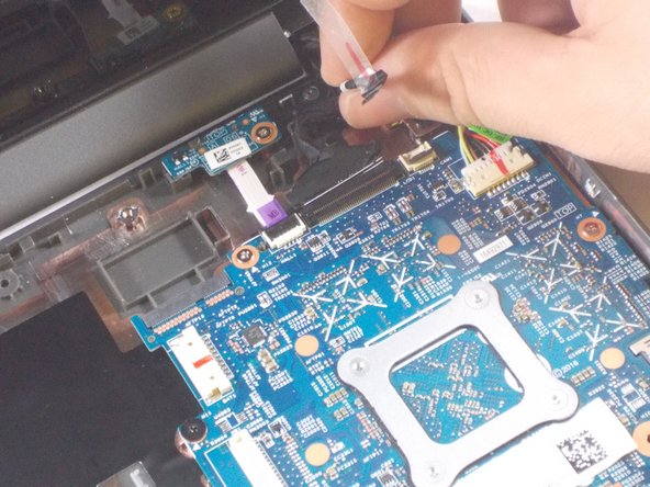

    5. HP Chromebook 11-v011dx Screen  Replacement: crwdns2935265:05crwdnd2935265:01crwdnd2935265:01crwdne2935265:0
      • Locate the black tab that holds a wire in place that keeps the keyboard connected to the mother board.
      • Slowly unplug this wire that connects to the key board.

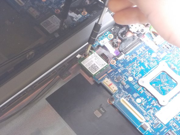

    1. HP Chromebook 11-v011dx Screen  Replacement, Screen: crwdns2935265:06crwdnd2935265:01crwdnd2935265:02crwdne2935265:0 HP Chromebook 11-v011dx Screen  Replacement, Screen: crwdns2935265:06crwdnd2935265:02crwdnd2935265:02crwdne2935265:0
      • Use a Phillips #0 screwdriver to remove the 1.3 mm screw that holds the wireless card.

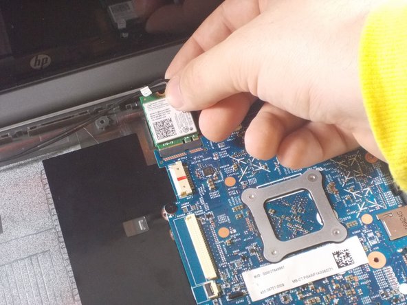

    2. HP Chromebook 11-v011dx Screen  Replacement: crwdns2935265:07crwdnd2935265:01crwdnd2935265:02crwdne2935265:0 HP Chromebook 11-v011dx Screen  Replacement: crwdns2935265:07crwdnd2935265:02crwdnd2935265:02crwdne2935265:0
      • Remove the wireless card from the motherboard with your own hand.

      • Find the wire that connects the screen to the motherboard.
      • Lift black tab that holds the wire in place.
      • Remove the wire.

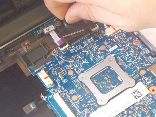

    4. HP Chromebook 11-v011dx Screen  Replacement: crwdns2935265:09crwdnd2935265:01crwdnd2935265:02crwdne2935265:0 HP Chromebook 11-v011dx Screen  Replacement: crwdns2935265:09crwdnd2935265:02crwdnd2935265:02crwdne2935265:0
      • Find the display cable that connects the screen to the motherboard.
      • Lift black tab that holds the display cable in place.
      • Remove display cable.

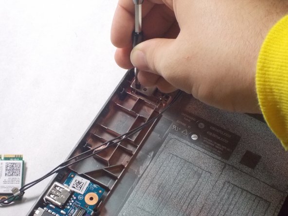

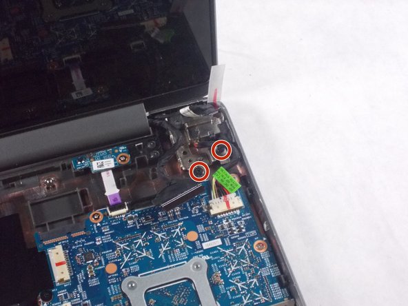

    5. HP Chromebook 11-v011dx Screen  Replacement: crwdns2935265:010crwdnd2935265:01crwdnd2935265:03crwdne2935265:0 HP Chromebook 11-v011dx Screen  Replacement: crwdns2935265:010crwdnd2935265:02crwdnd2935265:03crwdne2935265:0 HP Chromebook 11-v011dx Screen  Replacement: crwdns2935265:010crwdnd2935265:03crwdnd2935265:03crwdne2935265:0
      • Use a Phillips #0 screwdriver to remove the four 1.3mm screws that hold the screen in place.
      • Two screws are on the left of the laptop and two are on the right of the laptop.

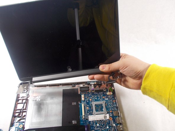

    6. HP Chromebook 11-v011dx Screen  Replacement: crwdns2935265:011crwdnd2935265:01crwdnd2935265:02crwdne2935265:0 HP Chromebook 11-v011dx Screen  Replacement: crwdns2935265:011crwdnd2935265:02crwdnd2935265:02crwdne2935265:0
      • Be careful when removing the screen so it doesn't get caught on any wires.
      • Remove the screen from the laptop.
