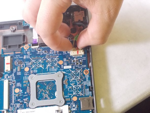

  18. HP Chromebook 11-v011dx Motherboard  Replacement, Motherboard: crwdns2935265:018crwdnd2935265:01crwdnd2935265:02crwdne2935265:0 HP Chromebook 11-v011dx Motherboard  Replacement, Motherboard: crwdns2935265:018crwdnd2935265:02crwdnd2935265:02crwdne2935265:0
    • Please hold the white tab and not the wires or it may rip the wires out.
    • Remove these wires that connect the motherboard to the power port.

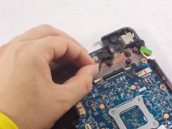

    • Locate the wire at the top of the motherboard.
    • Lift up the black tab that holds the wire in place.
    • Remove the wire.

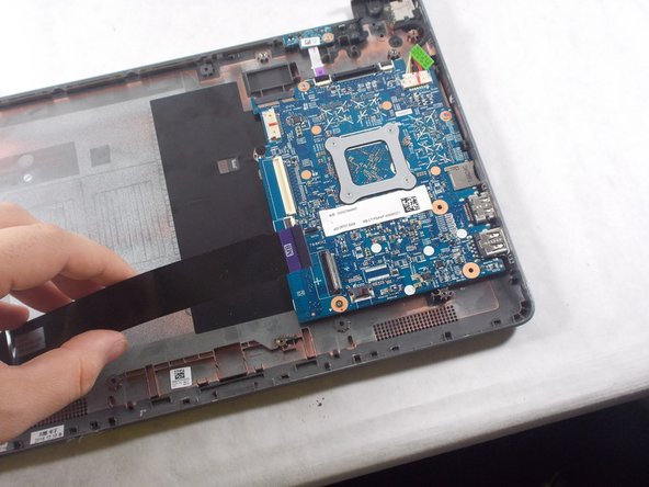

  20. HP Chromebook 11-v011dx Motherboard  Replacement: crwdns2935265:020crwdnd2935265:01crwdnd2935265:02crwdne2935265:0 HP Chromebook 11-v011dx Motherboard  Replacement: crwdns2935265:020crwdnd2935265:02crwdnd2935265:02crwdne2935265:0
    • Locate the wire that connects the USB port and the motherboard.
    • Lift up the black tap that holds the wire in place.
    • Remove the wire.

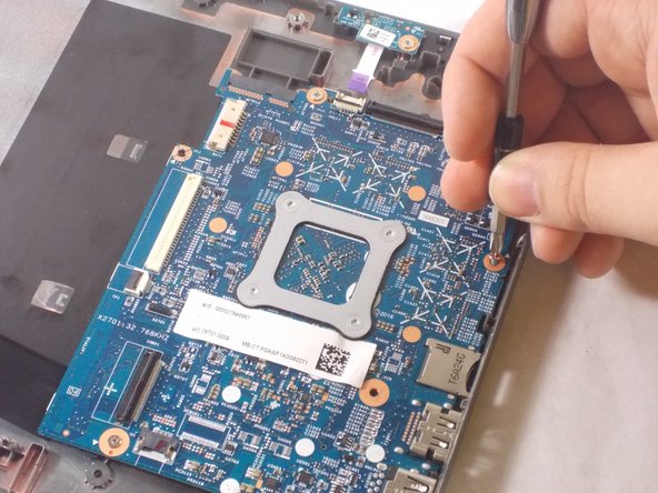

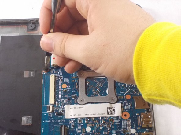

  21. HP Chromebook 11-v011dx Motherboard  Replacement: crwdns2935265:021crwdnd2935265:01crwdnd2935265:03crwdne2935265:0 HP Chromebook 11-v011dx Motherboard  Replacement: crwdns2935265:021crwdnd2935265:02crwdnd2935265:03crwdne2935265:0 HP Chromebook 11-v011dx Motherboard  Replacement: crwdns2935265:021crwdnd2935265:03crwdnd2935265:03crwdne2935265:0
    • Use a Phillips #0 screwdriver to remove five 1.3mm screws that hold the motherboard in place.

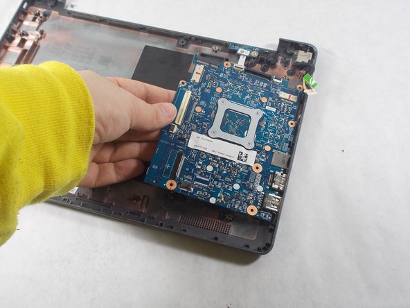

  22. HP Chromebook 11-v011dx Motherboard  Replacement: crwdns2935265:022crwdnd2935265:01crwdnd2935265:02crwdne2935265:0 HP Chromebook 11-v011dx Motherboard  Replacement: crwdns2935265:022crwdnd2935265:02crwdnd2935265:02crwdne2935265:0
    • Remove the motherboard by hand.
