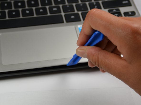

  3. HP Chromebook 11-v002dx WiFi Card Replacement: crwdns2935265:03crwdnd2935265:01crwdnd2935265:02crwdne2935265:0 HP Chromebook 11-v002dx WiFi Card Replacement: crwdns2935265:03crwdnd2935265:02crwdnd2935265:02crwdne2935265:0
    • Use a plastic opening tool to loosen the keyboard face from the device.
    • Start prying at one end of the laptop and slowly work your way around so as not to break the keyboard.

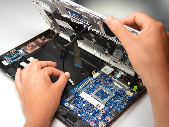

  4. HP Chromebook 11-v002dx WiFi Card Replacement: crwdns2935265:04crwdnd2935265:01crwdnd2935265:02crwdne2935265:0 HP Chromebook 11-v002dx WiFi Card Replacement: crwdns2935265:04crwdnd2935265:02crwdnd2935265:02crwdne2935265:0

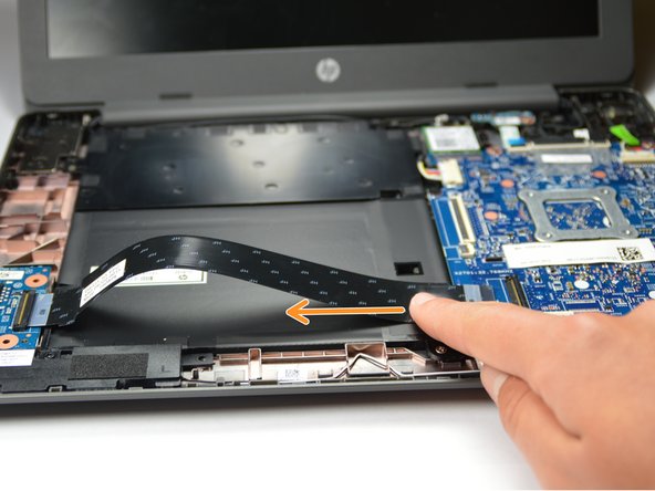

    • Lift the keyboard so that the inner workings of the laptop are exposed.
    • Gently pull each of the two ribbons connecting the keyboard to the device so that neither ribbon is still connected to the device, only to the keyboard.
  5. HP Chromebook 11-v002dx WiFi Card Replacement, Motherboard: crwdns2935265:05crwdnd2935265:01crwdnd2935265:02crwdne2935265:0 HP Chromebook 11-v002dx WiFi Card Replacement, Motherboard: crwdns2935265:05crwdnd2935265:02crwdnd2935265:02crwdne2935265:0
    • Pinch the thin black bar which holds the right side of the black ribbon down, and flip it up.
    • Gently pull the ribbon out of the black holder on its right, then out of the left side as well.

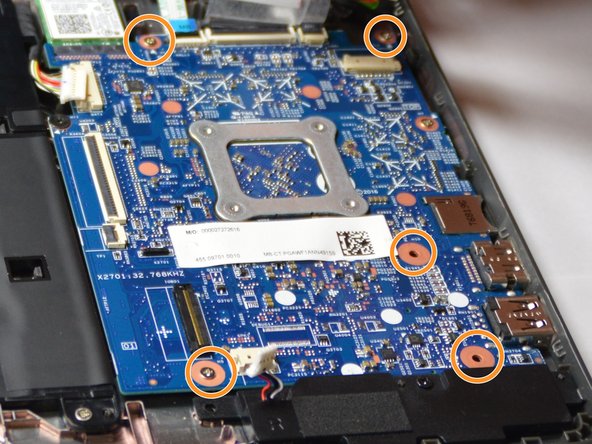

  6. HP Chromebook 11-v002dx WiFi Card Replacement: crwdns2935265:06crwdnd2935265:01crwdnd2935265:03crwdne2935265:0 HP Chromebook 11-v002dx WiFi Card Replacement: crwdns2935265:06crwdnd2935265:02crwdnd2935265:03crwdne2935265:0 HP Chromebook 11-v002dx WiFi Card Replacement: crwdns2935265:06crwdnd2935265:03crwdnd2935265:03crwdne2935265:0
    • Squeeze the three white connectors on their sides to disconnect them.
    • Use your Phillips #0 screwdriver to unscrew the five 0.2 mm screws from the motherboard.

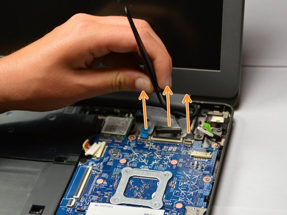

  7. HP Chromebook 11-v002dx WiFi Card Replacement: crwdns2935265:07crwdnd2935265:01crwdnd2935265:02crwdne2935265:0 HP Chromebook 11-v002dx WiFi Card Replacement: crwdns2935265:07crwdnd2935265:02crwdnd2935265:02crwdne2935265:0
    • Flip up the two clear tabs and the blue tab at the top of the motherboard.
    • Use your tweezers to lift each tab away so their connected components are no longer attached to the motherboard.

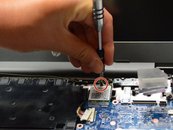

  8. HP Chromebook 11-v002dx WiFi Card Replacement: crwdns2935265:08crwdnd2935265:01crwdnd2935265:02crwdne2935265:0 HP Chromebook 11-v002dx WiFi Card Replacement: crwdns2935265:08crwdnd2935265:02crwdnd2935265:02crwdne2935265:0

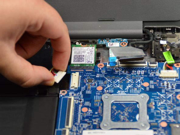

    • Use your tweezers to pull the two metal pieces connecting the two wires to the top of the green wifi card above the motherboard.
    • Use your Phillips head screwdriver to unscrew the 0.2 mm screw from the wifi card.

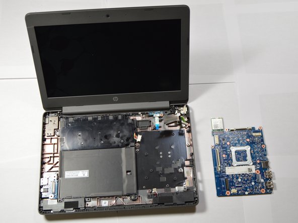

  9. HP Chromebook 11-v002dx WiFi Card Replacement: crwdns2935265:09crwdnd2935265:01crwdnd2935265:02crwdne2935265:0 HP Chromebook 11-v002dx WiFi Card Replacement: crwdns2935265:09crwdnd2935265:02crwdnd2935265:02crwdne2935265:0

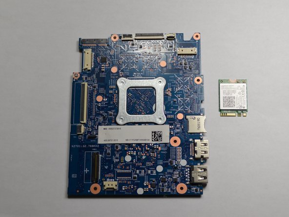

    • Grab the motherboard on its bottom right corner and pull it out of the laptop.
    • Ensure all connection points and motherboard are free of dust and any stickiness, then if necessary replace entire motherboard.
  10. HP Chromebook 11-v002dx WiFi Card Replacement, WiFi Card: crwdns2935265:010crwdnd2935265:01crwdnd2935265:02crwdne2935265:0 HP Chromebook 11-v002dx WiFi Card Replacement, WiFi Card: crwdns2935265:010crwdnd2935265:02crwdnd2935265:02crwdne2935265:0
    • Pull the green wifi card out of the motherboard.
