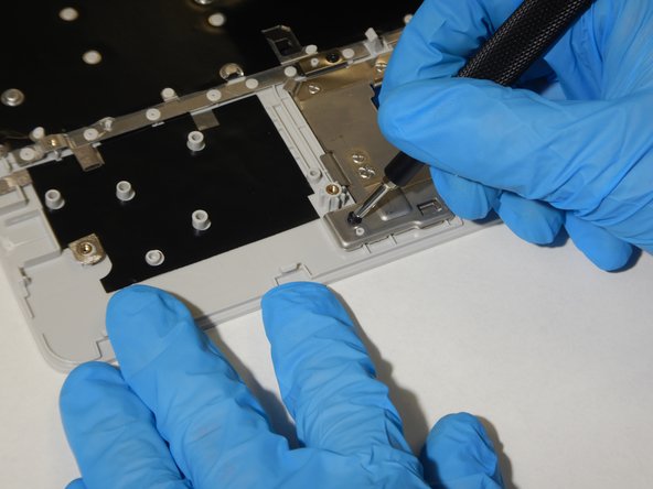

    • Using the Phillips #0 Screwdriver, remove the four 2.5mm screws on the bottom plate of the trackpad.

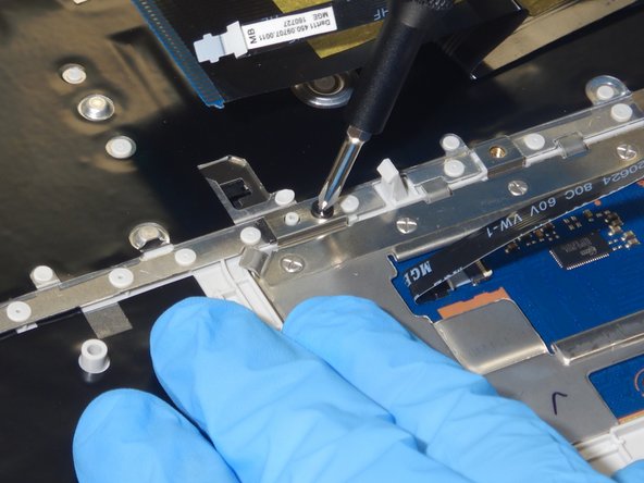

    • Using the Phillips # 0 Screwdriver, remove the three 2.5mm screws on the top of the trackpad.
