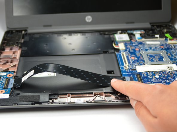

  4. HP Chromebook 11-v002dx Speakers Replacement: crwdns2935265:04crwdnd2935265:01crwdnd2935265:02crwdne2935265:0 HP Chromebook 11-v002dx Speakers Replacement: crwdns2935265:04crwdnd2935265:02crwdnd2935265:02crwdne2935265:0
    • Lift the keyboard so that the inner workings of the laptop are exposed.
    • Gently pull each of the two ribbons connecting the keyboard to the device so that neither ribbon is still connected to the device, only to the keyboard.

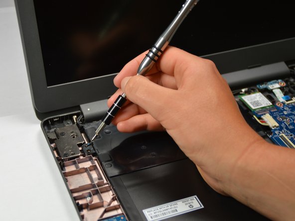

  5. HP Chromebook 11-v002dx Speakers Replacement, Battery: crwdns2935265:05crwdnd2935265:01crwdnd2935265:02crwdne2935265:0 HP Chromebook 11-v002dx Speakers Replacement, Battery: crwdns2935265:05crwdnd2935265:02crwdnd2935265:02crwdne2935265:0
    • Flip up the black tab on the far right of the wire ribbon.
    • Gently pull the wire out of the black holder on its right, then out of the left side as well.

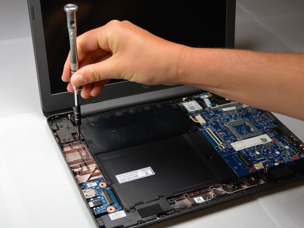

  6. HP Chromebook 11-v002dx Speakers Replacement: crwdns2935265:06crwdnd2935265:01crwdnd2935265:03crwdne2935265:0 HP Chromebook 11-v002dx Speakers Replacement: crwdns2935265:06crwdnd2935265:02crwdnd2935265:03crwdne2935265:0 HP Chromebook 11-v002dx Speakers Replacement: crwdns2935265:06crwdnd2935265:03crwdnd2935265:03crwdne2935265:0
    • Using your Phillips #0 screwdriver, remove the five 0.2 mm screws from the battery.

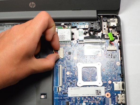

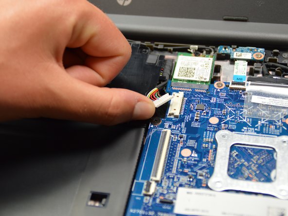

  7. HP Chromebook 11-v002dx Speakers Replacement: crwdns2935265:07crwdnd2935265:01crwdnd2935265:03crwdne2935265:0 HP Chromebook 11-v002dx Speakers Replacement: crwdns2935265:07crwdnd2935265:02crwdnd2935265:03crwdne2935265:0 HP Chromebook 11-v002dx Speakers Replacement: crwdns2935265:07crwdnd2935265:03crwdnd2935265:03crwdne2935265:0
    • Pinch the edges of the white tab with the wires coming out of the end.
    • Gently remove the white tab with the wires from its holder on the motherboard.

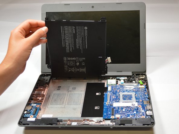

  8. HP Chromebook 11-v002dx Speakers Replacement: crwdns2935265:08crwdnd2935265:01crwdnd2935265:02crwdne2935265:0 HP Chromebook 11-v002dx Speakers Replacement: crwdns2935265:08crwdnd2935265:02crwdnd2935265:02crwdne2935265:0
    • Gently remove the battery from the laptop completely.
    • You can either clean your battery and connection ports or completely replace it.

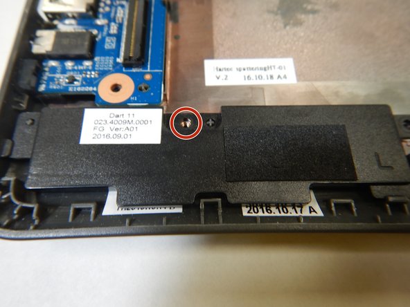

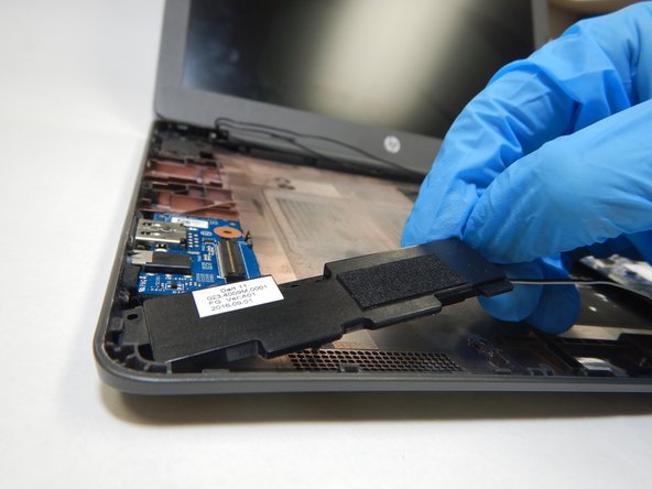

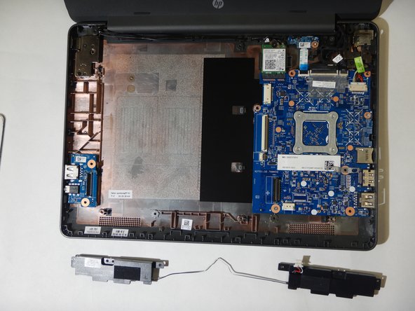

  9. HP Chromebook 11-v002dx Speakers Replacement, Speakers: crwdns2935265:09crwdnd2935265:01crwdnd2935265:01crwdne2935265:0
    • Remove the wire connecting the right speaker and motherboard.
  10. HP Chromebook 11-v002dx Speakers Replacement: crwdns2935265:010crwdnd2935265:01crwdnd2935265:02crwdne2935265:0 HP Chromebook 11-v002dx Speakers Replacement: crwdns2935265:010crwdnd2935265:02crwdnd2935265:02crwdne2935265:0
    • Using a Phillips #0 Screwdriver, remove the single 5mm screw connecting the left and right speakers to the casing.
  11. HP Chromebook 11-v002dx Speakers Replacement: crwdns2935265:011crwdnd2935265:01crwdnd2935265:03crwdne2935265:0 HP Chromebook 11-v002dx Speakers Replacement: crwdns2935265:011crwdnd2935265:02crwdnd2935265:03crwdne2935265:0 HP Chromebook 11-v002dx Speakers Replacement: crwdns2935265:011crwdnd2935265:03crwdnd2935265:03crwdne2935265:0
    • Gently lift the speakers out of the casing.
