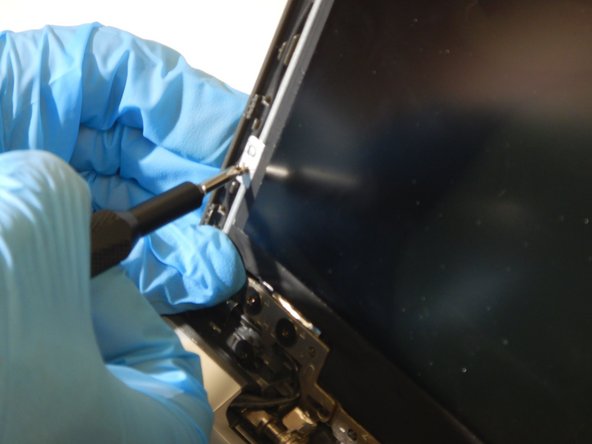

    • Insert your spudger between the plastic covering and the back of the case.
  2. HP Chromebook 11-v002dx Screen Replacement: crwdns2935265:02crwdnd2935265:01crwdnd2935265:01crwdne2935265:0
    • With the help of your spudger completely remove the plastic cover from the rest of the case.

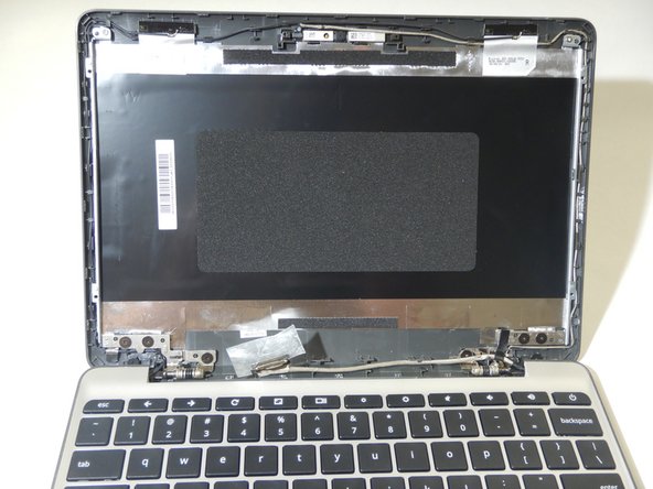

  3. HP Chromebook 11-v002dx Screen Replacement: crwdns2935265:03crwdnd2935265:01crwdnd2935265:01crwdne2935265:0
    • Your screen will look like this.
  4. HP Chromebook 11-v002dx Screen Replacement: crwdns2935265:04crwdnd2935265:01crwdnd2935265:02crwdne2935265:0 HP Chromebook 11-v002dx Screen Replacement: crwdns2935265:04crwdnd2935265:02crwdnd2935265:02crwdne2935265:0
    • Using a Phillips #0 Screwdriver, remove the four 2.5mm screws holding the screen in place.
  5. HP Chromebook 11-v002dx Screen Replacement: crwdns2935265:05crwdnd2935265:01crwdnd2935265:01crwdne2935265:0
    • Remove the tape covering the wiring and detach the ribbon cable that secures the screen to the motherboard.
    • Use tweezers if you can't reach it with your fingers.
  6. HP Chromebook 11-v002dx Screen Replacement: crwdns2935265:06crwdnd2935265:01crwdnd2935265:02crwdne2935265:0 HP Chromebook 11-v002dx Screen Replacement: crwdns2935265:06crwdnd2935265:02crwdnd2935265:02crwdne2935265:0
    • Remove the display and the case.
