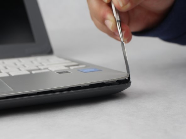

    • Turn the Laptop over and with the metal spudger start to run it along the plastic seam to pry it off.
    • You will hear popping sounds when you are sliding the spudger along the device.
    • For an easier removal, start from the sides and work your way in to the corners.

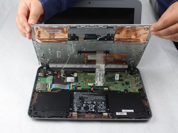

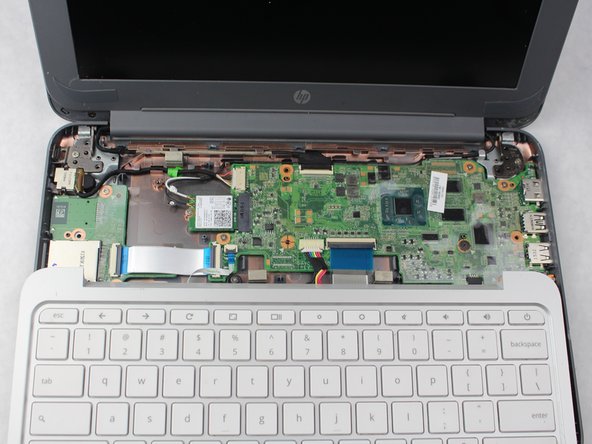

  4. HP Chromebook 11-2210nr Speakers Replacement: crwdns2935265:04crwdnd2935265:01crwdnd2935265:03crwdne2935265:0 HP Chromebook 11-2210nr Speakers Replacement: crwdns2935265:04crwdnd2935265:02crwdnd2935265:03crwdne2935265:0 HP Chromebook 11-2210nr Speakers Replacement: crwdns2935265:04crwdnd2935265:03crwdnd2935265:03crwdne2935265:0

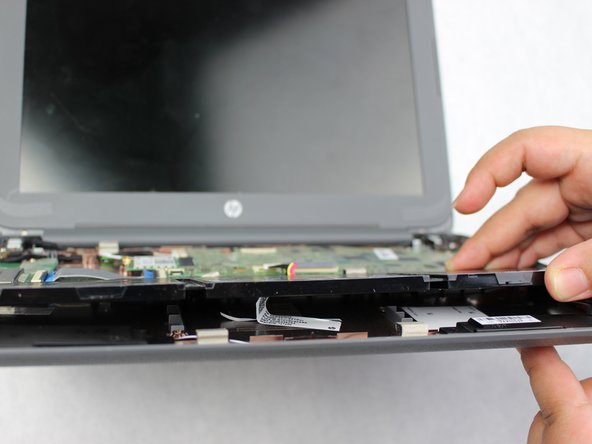

    • Carefully lift off the keyboard and gently place it towards you until the two ZIF ribbon wires become visible and place the keyboard down.
    • Locate where the two ZIF ribbon wires are connecting the keyboard to the motherboard in place by clasps.
    • This does not disconnect the keyboard from the laptop just yet.

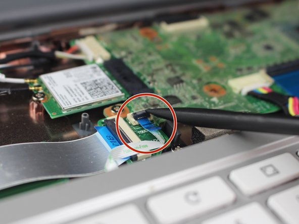

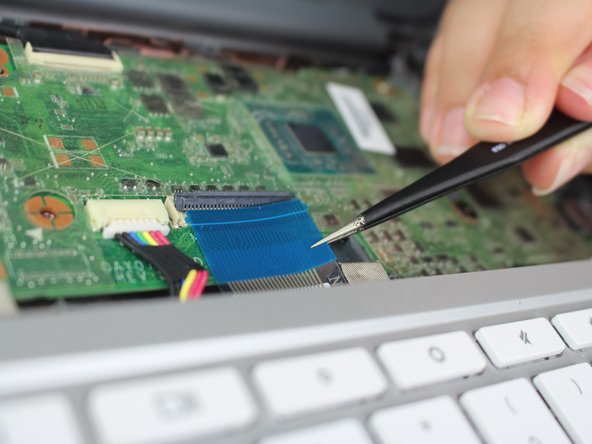

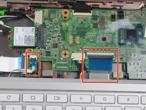

  5. HP Chromebook 11-2210nr Speakers Replacement: crwdns2935265:05crwdnd2935265:01crwdnd2935265:03crwdne2935265:0 HP Chromebook 11-2210nr Speakers Replacement: crwdns2935265:05crwdnd2935265:02crwdnd2935265:03crwdne2935265:0 HP Chromebook 11-2210nr Speakers Replacement: crwdns2935265:05crwdnd2935265:03crwdnd2935265:03crwdne2935265:0
    • Using the nylon spudger, lift the plastic clasps holding the two ribbon wires up to properly disconnect the wires.
    • It is recommended to use the nylon spudger for this step. Any metal can damage your motherboard.
    • This step completely disconnects the keyboard to allow safe removal and replacement.

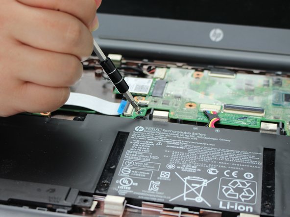

  6. HP Chromebook 11-2210nr Speakers Replacement: crwdns2935265:06crwdnd2935265:01crwdnd2935265:02crwdne2935265:0 HP Chromebook 11-2210nr Speakers Replacement: crwdns2935265:06crwdnd2935265:02crwdnd2935265:02crwdne2935265:0

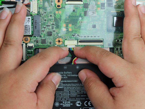

    • Remove the six 4mm screws holding the battery in place with a Phillips #1 screwdriver.

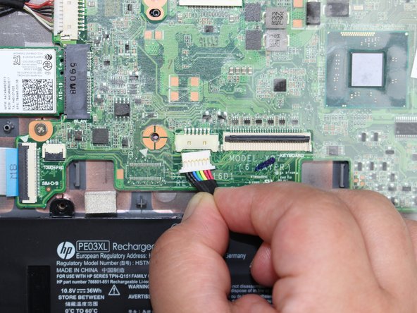

  7. HP Chromebook 11-2210nr Speakers Replacement: crwdns2935265:07crwdnd2935265:01crwdnd2935265:03crwdne2935265:0 HP Chromebook 11-2210nr Speakers Replacement: crwdns2935265:07crwdnd2935265:02crwdnd2935265:03crwdne2935265:0 HP Chromebook 11-2210nr Speakers Replacement: crwdns2935265:07crwdnd2935265:03crwdnd2935265:03crwdne2935265:0
    • Carefully unplug the bundle power cable by pulling both edges towards you.
    • This successfully disconnects the battery from the laptop.

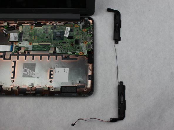

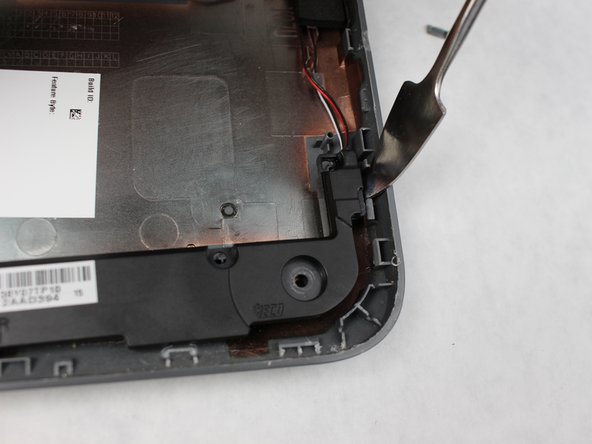

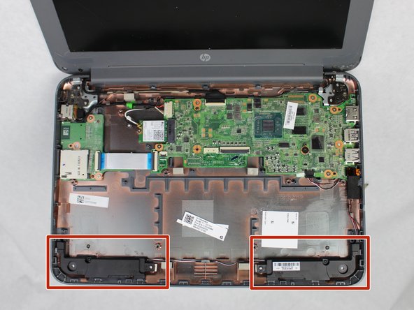

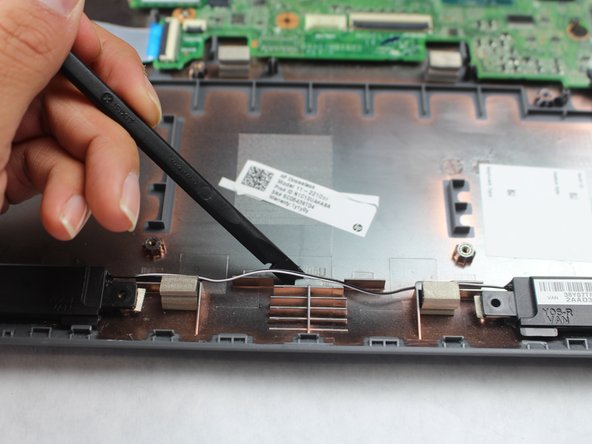

  9. HP Chromebook 11-2210nr Speakers Replacement: crwdns2935265:09crwdnd2935265:01crwdnd2935265:03crwdne2935265:0 HP Chromebook 11-2210nr Speakers Replacement: crwdns2935265:09crwdnd2935265:02crwdnd2935265:03crwdne2935265:0 HP Chromebook 11-2210nr Speakers Replacement: crwdns2935265:09crwdnd2935265:03crwdnd2935265:03crwdne2935265:0
    • Use the metal spudger to release the LEFT speakers from the laptop.
    • Use the metal spudger to release the RIGHT speaker from the laptop.
    • The two speakers are connected to a wire that runs along the bottom edge of the laptop and connected up to the motherboard.

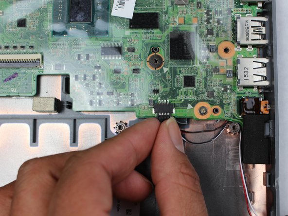

  10. HP Chromebook 11-2210nr Speakers Replacement: crwdns2935265:010crwdnd2935265:01crwdnd2935265:03crwdne2935265:0 HP Chromebook 11-2210nr Speakers Replacement: crwdns2935265:010crwdnd2935265:02crwdnd2935265:03crwdne2935265:0 HP Chromebook 11-2210nr Speakers Replacement: crwdns2935265:010crwdnd2935265:03crwdnd2935265:03crwdne2935265:0

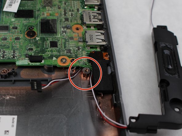

    • Unplug the speakers small wire bundle from the motherboard.
    • You will notice the speaker wire is pinched between a screw slot and underneath the motherboard.

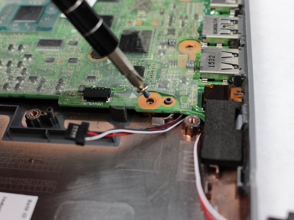

  11. HP Chromebook 11-2210nr Speakers Replacement: crwdns2935265:011crwdnd2935265:01crwdnd2935265:02crwdne2935265:0 HP Chromebook 11-2210nr Speakers Replacement: crwdns2935265:011crwdnd2935265:02crwdnd2935265:02crwdne2935265:0
    • Remove the one 4mm screw located above the pinched wire.

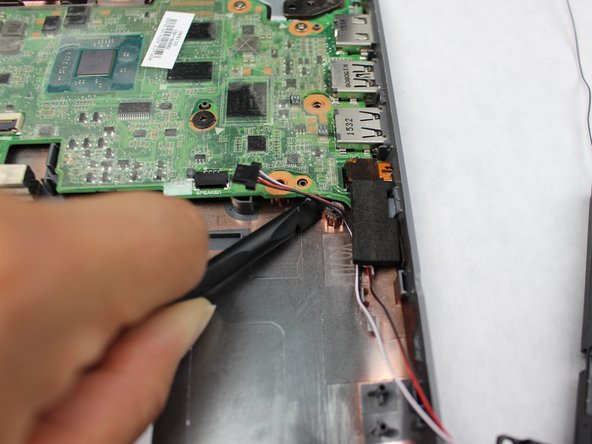

  12. HP Chromebook 11-2210nr Speakers Replacement: crwdns2935265:012crwdnd2935265:01crwdnd2935265:03crwdne2935265:0 HP Chromebook 11-2210nr Speakers Replacement: crwdns2935265:012crwdnd2935265:02crwdnd2935265:03crwdne2935265:0 HP Chromebook 11-2210nr Speakers Replacement: crwdns2935265:012crwdnd2935265:03crwdnd2935265:03crwdne2935265:0
    • Using the nylon spudger, slightly pry up the motherboard to release the pinched wire.
    • This step completely disconnects the speaker from the laptop to be safely removed.
