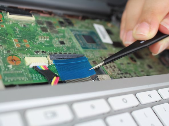

  5. HP Chromebook 11-2210nr SD Card Reader Replacement: crwdns2935265:05crwdnd2935265:01crwdnd2935265:03crwdne2935265:0 HP Chromebook 11-2210nr SD Card Reader Replacement: crwdns2935265:05crwdnd2935265:02crwdnd2935265:03crwdne2935265:0 HP Chromebook 11-2210nr SD Card Reader Replacement: crwdns2935265:05crwdnd2935265:03crwdnd2935265:03crwdne2935265:0
    • Using the nylon spudger, push the plastic clasps holding the two ribbon wires up to properly disconnect the wires.
    • You must use the nylon spudger for this step. Any metal can damage your motherboard.
    • This step completely disconnects the keyboard to allow safe removal and replacement.

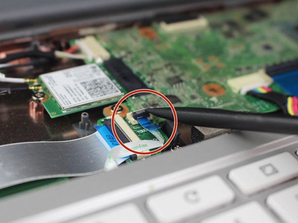

  6. HP Chromebook 11-2210nr SD Card Reader Replacement: crwdns2935265:06crwdnd2935265:01crwdnd2935265:03crwdne2935265:0 HP Chromebook 11-2210nr SD Card Reader Replacement: crwdns2935265:06crwdnd2935265:02crwdnd2935265:03crwdne2935265:0 HP Chromebook 11-2210nr SD Card Reader Replacement: crwdns2935265:06crwdnd2935265:03crwdnd2935265:03crwdne2935265:0
    • Locate the SD card reader at the top left corner above the battery.
    • Flip up the plastic clasps holding the ZIF connectors into place by using the nylon spudger or your finger.
    • Gently slide out the ribbon cable, removing it from the SD Card Reader.
