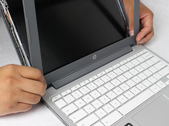

    • Using a metal spudger, gently pry the front plastic frame (or bezel) off of the device by inserting the tool along the inside edge of the bezel.
    • Completely open the screen as far as possible to remove the bottom edge of the bezel from the laptop.
    • Be sure to disconnect the bezel from all the way around the screen before completely removing.

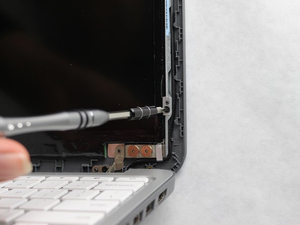

    • Remove the four black 3 mm screws along the left and right sides of the LCD screen using a Phillips #0 screwdriver.

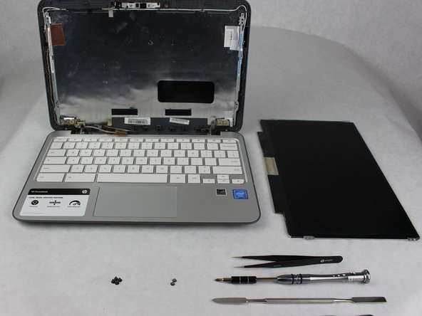

  5. HP Chromebook 11-2210nr LCD Screen Replacement: crwdns2935265:05crwdnd2935265:01crwdnd2935265:01crwdne2935265:0
    • After removing all screws, gently lower the LCD screen onto the keyboard.
    • The LCD screen will not be completely disconnected from the laptop just yet.

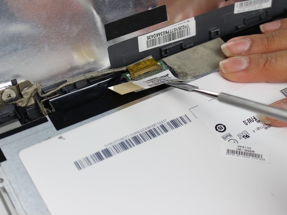

    • Gently use the spudger to pry off the tape on top of the gold chip. You may also use your hands to gently remove the tape.
  7. HP Chromebook 11-2210nr LCD Screen Replacement: crwdns2935265:07crwdnd2935265:01crwdnd2935265:02crwdne2935265:0 HP Chromebook 11-2210nr LCD Screen Replacement: crwdns2935265:07crwdnd2935265:02crwdnd2935265:02crwdne2935265:0
    • Remove the display cable by gently sliding out the cable away from the LCD screen.
    • This action disconnects the LCD screen from the rest of the device, allowing it to be completely removed.
