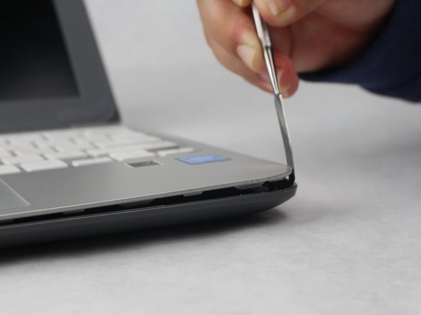

      • Turn the Laptop over and with the metal spudger start to run it along the plastic seam to pry it off.
      • You will hear popping sounds when you are sliding the spudger along the device.
      • For an easier removal, start from the sides and work your way in to the corners.

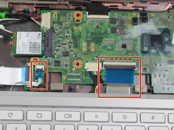

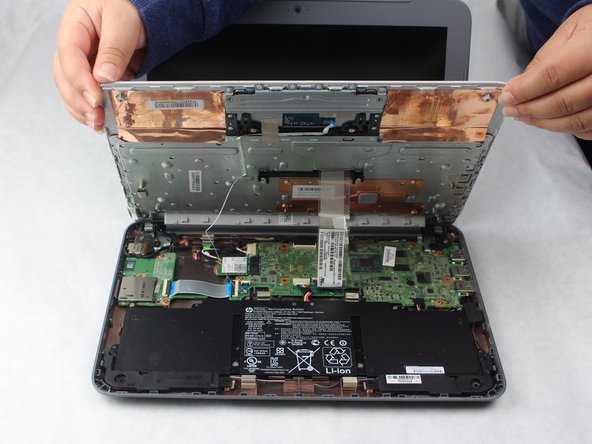

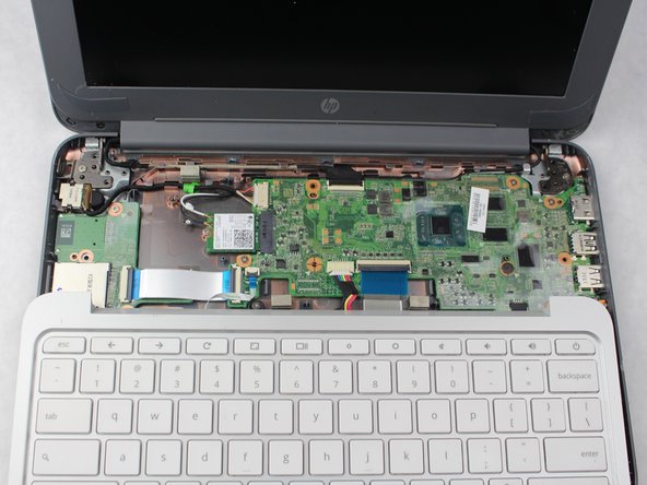

      • Carefully lift off the keyboard and gently place it towards you until the two ribbon wires become visible and place the keyboard down.
      • Locate where the two ribbon wires are being held in place by two chips.
      • This does not disconnect the keyboard from the laptop just yet.

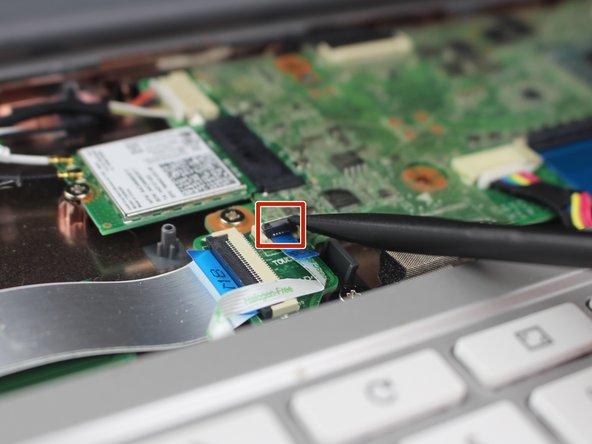

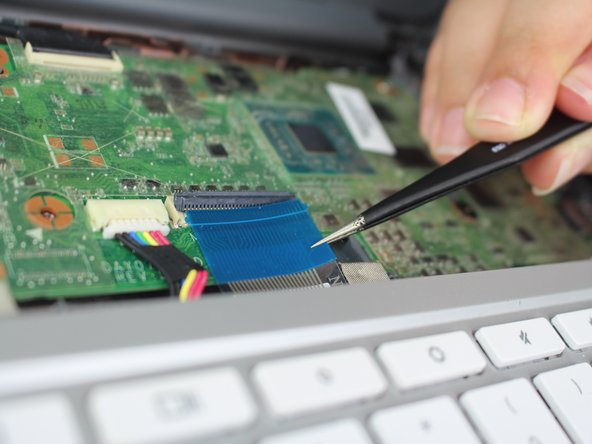

      • Using the nylon spudger, lift the plastic clasps holding the two ribbon wires up to properly disconnect the wires.
      • It is recommended to use the nylon spudger for this step. Any metal can damage your motherboard.
      • This step completely disconnects the keyboard to allow safe removal and replacement.
