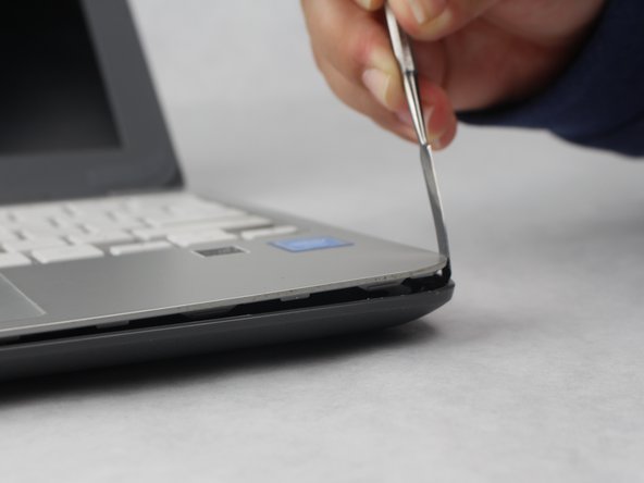

  3. HP Chromebook 11-2210nr Battery Replacement: crwdns2935265:03crwdnd2935265:01crwdnd2935265:03crwdne2935265:0 HP Chromebook 11-2210nr Battery Replacement: crwdns2935265:03crwdnd2935265:02crwdnd2935265:03crwdne2935265:0 HP Chromebook 11-2210nr Battery Replacement: crwdns2935265:03crwdnd2935265:03crwdnd2935265:03crwdne2935265:0

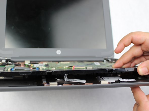

    • Turn the Laptop over, and with the metal spudger start to run it along the plastic seam to pry it off.
    • You will hear popping sounds when you are sliding the spudger along the device.
    • For an easier removal, start from the sides and work your way in to the corners.
    • Be careful when using the metal spudger as it could cause damage to the internals of the device. Don't push the spudger too deeply into the seam.

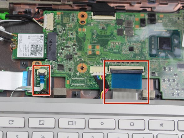

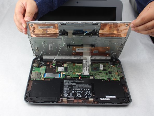

    • Carefully lift the keyboard up and gently place it towards you until the two ribbon wires become visible and place the keyboard down.
    • Locate where the two ribbon wires are being held in place by two locks.
    • This does not disconnect the keyboard from the laptop just yet.

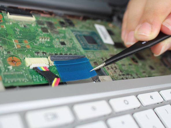

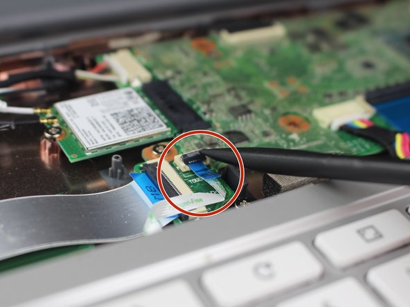

  5. HP Chromebook 11-2210nr Battery Replacement: crwdns2935265:05crwdnd2935265:01crwdnd2935265:03crwdne2935265:0 HP Chromebook 11-2210nr Battery Replacement: crwdns2935265:05crwdnd2935265:02crwdnd2935265:03crwdne2935265:0 HP Chromebook 11-2210nr Battery Replacement: crwdns2935265:05crwdnd2935265:03crwdnd2935265:03crwdne2935265:0
    • Using the nylon spudger, push the plastic clasps holding the two ribbon wires up to properly disconnect the wires.
    • It is important to use the nylon spudger for this step to avoid any metal on metal circuit damage.
    • This step completely disconnects the keyboard to allow safe removal.

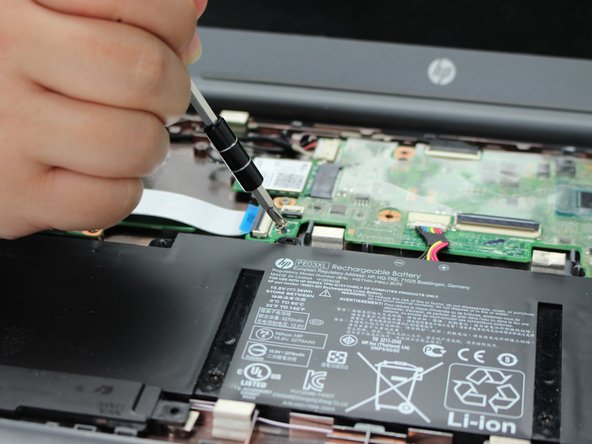

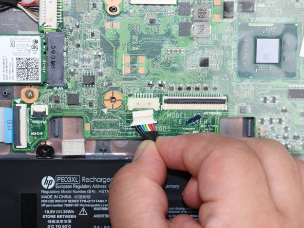

    • Remove the six 4 mm screws holding the battery in place with a Phillips #1 screwdriver.

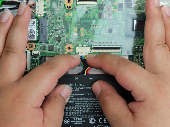

  7. HP Chromebook 11-2210nr Battery Replacement: crwdns2935265:07crwdnd2935265:01crwdnd2935265:03crwdne2935265:0 HP Chromebook 11-2210nr Battery Replacement: crwdns2935265:07crwdnd2935265:02crwdnd2935265:03crwdne2935265:0 HP Chromebook 11-2210nr Battery Replacement: crwdns2935265:07crwdnd2935265:03crwdnd2935265:03crwdne2935265:0

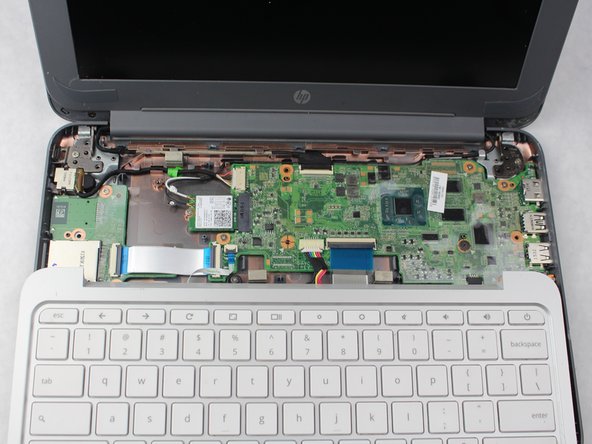

    • Carefully unplug the bundle power cable by pulling both edges towards you.
    • This successfully disconnects the battery from the laptop.
  8. HP Chromebook 11-2210nr Battery Replacement: crwdns2935265:08crwdnd2935265:01crwdnd2935265:03crwdne2935265:0 HP Chromebook 11-2210nr Battery Replacement: crwdns2935265:08crwdnd2935265:02crwdnd2935265:03crwdne2935265:0 HP Chromebook 11-2210nr Battery Replacement: crwdns2935265:08crwdnd2935265:03crwdnd2935265:03crwdne2935265:0
    • Carefully lift the battery and remove it from the laptop.
    • The battery may have an adhesive sticker attached to the bottom, if so apply more force when lifting up.
