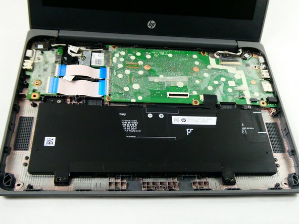

  10. HP Chromebook 11 G8 EE Motherboard Replacement: crwdns2935265:010crwdnd2935265:01crwdnd2935265:02crwdne2935265:0 HP Chromebook 11 G8 EE Motherboard Replacement: crwdns2935265:010crwdnd2935265:02crwdnd2935265:02crwdne2935265:0
    • Carefully lift the battery up and out.
  11. HP Chromebook 11 G8 EE Motherboard Replacement, Motherboard: crwdns2935265:011crwdnd2935265:01crwdnd2935265:03crwdne2935265:0 HP Chromebook 11 G8 EE Motherboard Replacement, Motherboard: crwdns2935265:011crwdnd2935265:02crwdnd2935265:03crwdne2935265:0 HP Chromebook 11 G8 EE Motherboard Replacement, Motherboard: crwdns2935265:011crwdnd2935265:03crwdnd2935265:03crwdne2935265:0

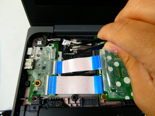

  13. HP Chromebook 11 G8 EE Motherboard Replacement: crwdns2935265:013crwdnd2935265:01crwdnd2935265:03crwdne2935265:0 HP Chromebook 11 G8 EE Motherboard Replacement: crwdns2935265:013crwdnd2935265:02crwdnd2935265:03crwdne2935265:0 HP Chromebook 11 G8 EE Motherboard Replacement: crwdns2935265:013crwdnd2935265:03crwdnd2935265:03crwdne2935265:0
    • Flip the two black lock bars on the ZIF connectors using tweezers.
    • Disconnect both ribbon cables from the motherboard using the tweezers.

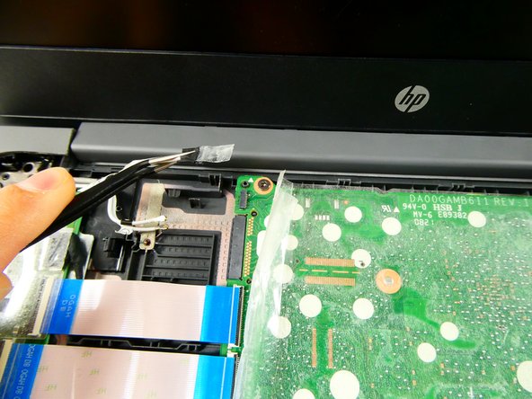

  15. HP Chromebook 11 G8 EE Motherboard Replacement: crwdns2935265:015crwdnd2935265:01crwdnd2935265:02crwdne2935265:0 HP Chromebook 11 G8 EE Motherboard Replacement: crwdns2935265:015crwdnd2935265:02crwdnd2935265:02crwdne2935265:0
    • Peel back the film and lift the lock bar on the display panel cable with tweezers.
    • Disconnect the display panel connector with tweezers.
