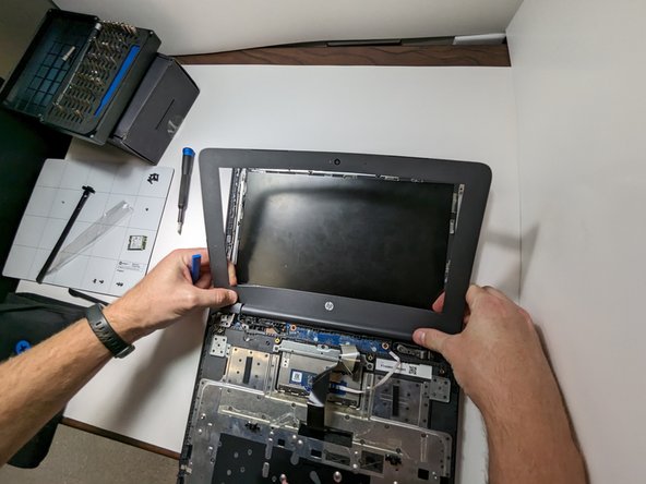

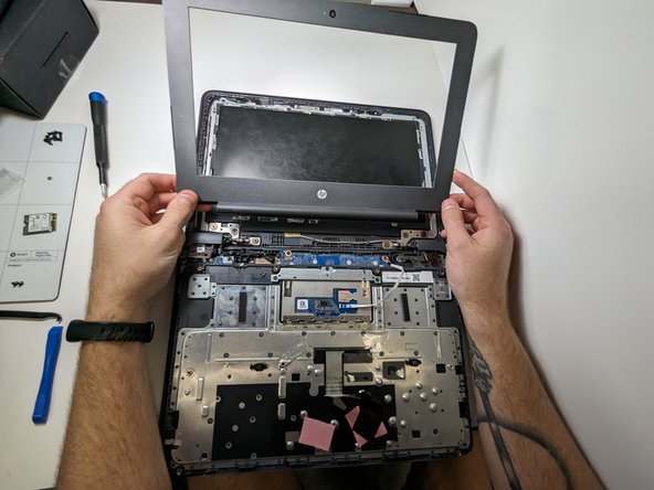

    1. HP Chromebook 11 G6 EE Webcam Camera Module Replacement, Webcam Camera Module: crwdns2935265:04crwdnd2935265:01crwdnd2935265:03crwdne2935265:0 HP Chromebook 11 G6 EE Webcam Camera Module Replacement, Webcam Camera Module: crwdns2935265:04crwdnd2935265:02crwdnd2935265:03crwdne2935265:0 HP Chromebook 11 G6 EE Webcam Camera Module Replacement, Webcam Camera Module: crwdns2935265:04crwdnd2935265:03crwdnd2935265:03crwdne2935265:0
      • Use the opening pick around the edges of the screen bezel carefully to remove.
      • Remove screen bezel.

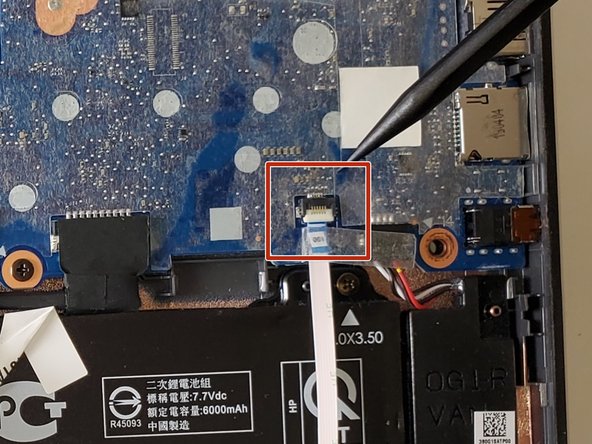

    2. HP Chromebook 11 G6 EE Webcam Camera Module Replacement: crwdns2935265:05crwdnd2935265:01crwdnd2935265:03crwdne2935265:0 HP Chromebook 11 G6 EE Webcam Camera Module Replacement: crwdns2935265:05crwdnd2935265:02crwdnd2935265:03crwdne2935265:0 HP Chromebook 11 G6 EE Webcam Camera Module Replacement: crwdns2935265:05crwdnd2935265:03crwdnd2935265:03crwdne2935265:0
      • Peel back the tape that secures the webcam to the left display panel hinge.
      • Gently slide out the webcam connector.

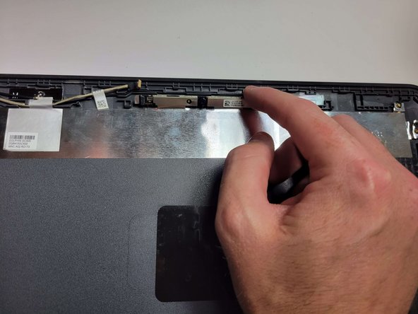

    3. HP Chromebook 11 G6 EE Webcam Camera Module Replacement: crwdns2935265:06crwdnd2935265:01crwdnd2935265:02crwdne2935265:0 HP Chromebook 11 G6 EE Webcam Camera Module Replacement: crwdns2935265:06crwdnd2935265:02crwdnd2935265:02crwdne2935265:0
      • Place the iFixit opening tool under the webcam module.
      • This is will probably bend the metal due to the strong adhesive in place.
      • Using the iFixit tool work the tool around the top edge of the webcam module to loosen the module.
      • Use your fingers to lift the webcam module out of its setting.
