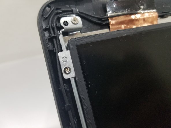

  3. HP Chromebook 11 G5 Screen Replacement: crwdns2935265:03crwdnd2935265:01crwdnd2935265:02crwdne2935265:0 HP Chromebook 11 G5 Screen Replacement: crwdns2935265:03crwdnd2935265:02crwdnd2935265:02crwdne2935265:0
    • Unscrew the four silver 4mm Phillips #0 screws on the edges of the display.
    • To ensure that the LCD panel does not immediately slide down upon removing the screws, make sure the display is still tilted as far back as possible.

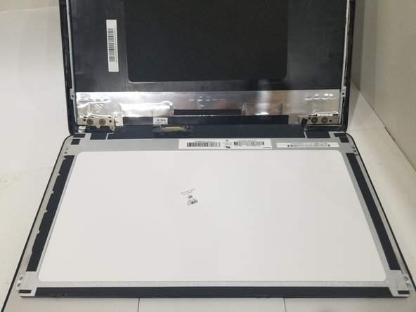

  4. HP Chromebook 11 G5 Screen Replacement: crwdns2935265:04crwdnd2935265:01crwdnd2935265:02crwdne2935265:0 HP Chromebook 11 G5 Screen Replacement: crwdns2935265:04crwdnd2935265:02crwdnd2935265:02crwdne2935265:0
    • Gently lift the LCD panel out of the body and lower it onto the keyboard deck.
    • Ensure that the power button is not accidentally pressed while lowering the display.

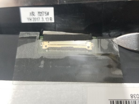

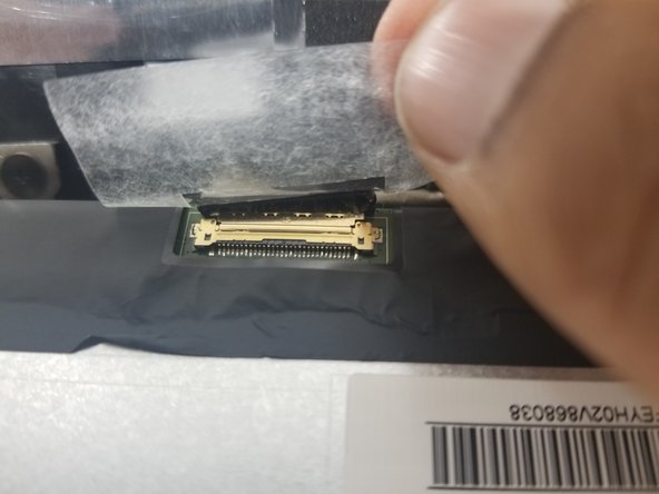

    • Identify the eDP 30-pin connector and use the sharp end of the spudger to peel off a corner of the tape over the connector.
    • To avoid damaging internal components, only use a metal spudger as a last resort.
    • Use your fingers to peel off the rest of the tape.
    • Peel the tape slowly to ensure that the connector does not get pulled while peeling the tape.
  6. HP Chromebook 11 G5 Screen Replacement: crwdns2935265:06crwdnd2935265:01crwdnd2935265:01crwdne2935265:0
    • Hold both sides of the tape and gently push back the connector to disconnect the display.
    • When attaching the new display, make sure there is no gap between the connector and its socket.
    • Two audible clicks should be heard when the connector is reattached, one click for each side of the connector.
