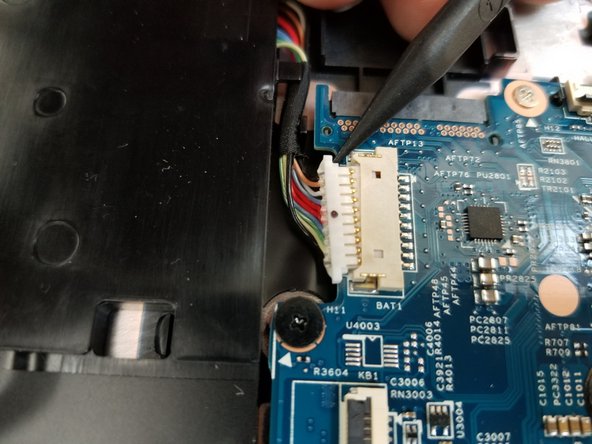

  12. HP Chromebook 11 G5 Motherboard Replacement: crwdns2935265:012crwdnd2935265:01crwdnd2935265:02crwdne2935265:0 HP Chromebook 11 G5 Motherboard Replacement: crwdns2935265:012crwdnd2935265:02crwdnd2935265:02crwdne2935265:0
    • Remove the battery connector by pushing both ends away from the motherboard one at a time using the pointed end of a spudger.

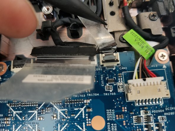

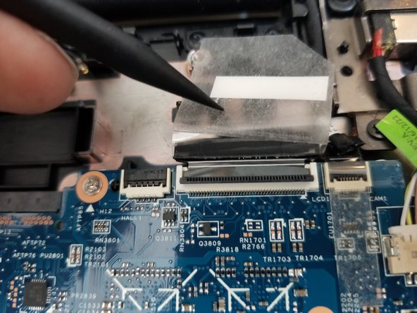

  14. HP Chromebook 11 G5 Motherboard Replacement: crwdns2935265:014crwdnd2935265:01crwdnd2935265:02crwdne2935265:0 HP Chromebook 11 G5 Motherboard Replacement: crwdns2935265:014crwdnd2935265:02crwdnd2935265:02crwdne2935265:0
    • Peel the tape over the display cable before lifting the plastic connector lid holding it in place by using the pointed end of a spudger.
    • Remove the cable by gently pulling it with your hand.
    • Handle ribbon cables carefully as they are fragile and easily torn.
  15. HP Chromebook 11 G5 Motherboard Replacement: crwdns2935265:015crwdnd2935265:01crwdnd2935265:02crwdne2935265:0 HP Chromebook 11 G5 Motherboard Replacement: crwdns2935265:015crwdnd2935265:02crwdnd2935265:02crwdne2935265:0
    • Peel the tape over the camera connector before lifting the plastic connector lid holding it in place by using the pointed end of a spudger.
