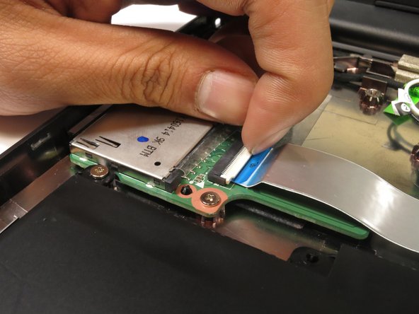

  9. HP Chromebook 11 G4 SD Card Reader Replacement, SD Card Reader: crwdns2935265:09crwdnd2935265:01crwdnd2935265:03crwdne2935265:0 HP Chromebook 11 G4 SD Card Reader Replacement, SD Card Reader: crwdns2935265:09crwdnd2935265:02crwdnd2935265:03crwdne2935265:0 HP Chromebook 11 G4 SD Card Reader Replacement, SD Card Reader: crwdns2935265:09crwdnd2935265:03crwdnd2935265:03crwdne2935265:0
    • Flip up the flap on the ZIP connector with your finger.
    • Gently pull out the ribbon cable.

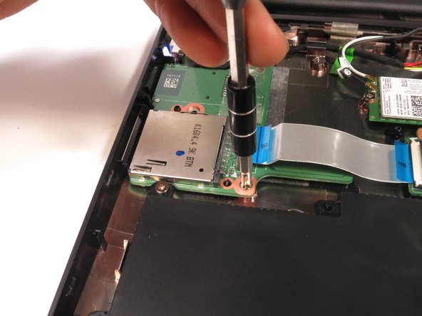

  10. HP Chromebook 11 G4 SD Card Reader Replacement: crwdns2935265:010crwdnd2935265:01crwdnd2935265:02crwdne2935265:0 HP Chromebook 11 G4 SD Card Reader Replacement: crwdns2935265:010crwdnd2935265:02crwdnd2935265:02crwdne2935265:0
    • Remove the two 4 mm Phillips #1 screws.

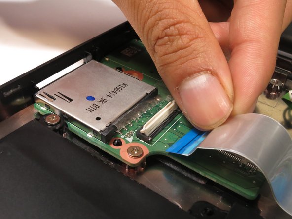

  11. HP Chromebook 11 G4 SD Card Reader Replacement: crwdns2935265:011crwdnd2935265:01crwdnd2935265:02crwdne2935265:0 HP Chromebook 11 G4 SD Card Reader Replacement: crwdns2935265:011crwdnd2935265:02crwdnd2935265:02crwdne2935265:0
    • Lift the ribbon cable back and out of the way.
    • Pull out the SD card reader.
