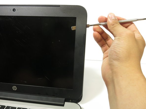

    • Open the laptop.
    • With the plastic spudger or your fingers, gently peel off the two thin adhesive layers at the left and right bottom edges of the screen.
    • Do not pry up the plastic bezel (monitor frame), just the adhesive layer.
    • If the adhesive layer isn't coming off, use a metal spudger.

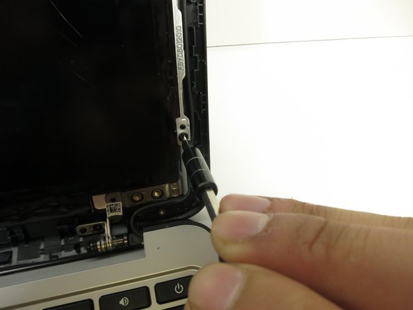

    • Remove the two 3 mm Phillips #00 screws located underneath the adhesive layers that were removed in the previous step

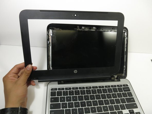

    • Gently pry up the plastic bezel with the small, narrow end of the metal spudger.
    • Insert the long, flat end of the metal spudger into the gap.
    • Slide the metal spudger along the edge to disconnect the bezel from the laptop
    • You should hear popping sounds as you slide the spudger along the edge.
    • If the spudger gets stuck while sliding, it's okay to use more force.

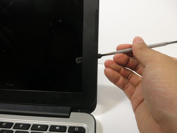

  4. HP Chromebook 11 G4 LCD Replacement: crwdns2935265:04crwdnd2935265:01crwdnd2935265:02crwdne2935265:0 HP Chromebook 11 G4 LCD Replacement: crwdns2935265:04crwdnd2935265:02crwdnd2935265:02crwdne2935265:0
    • Tilt the laptop screen as far back as possible
    • Hold the bezel with both hands, then pull the bezel towards you to disconnect the bottom edge of the bezel from the laptop.
    • You may have to use extra force for this step

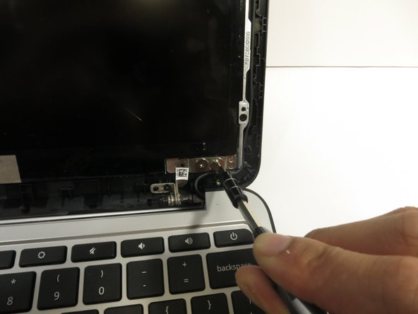

    • Remove the four silver 4 mm Phillips #0 screws at the bottom of the LCD.
    • Remove the four black 3 mm Phillips #00 screws along the perimeter of the LCD.

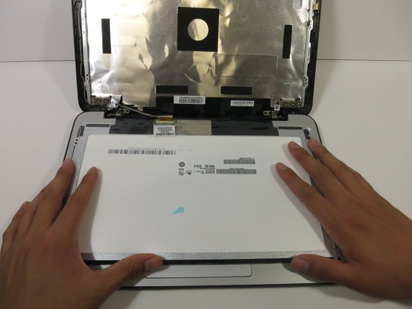

    • Lift the LCD off its mount and gently lay it facedown on the keyboard.

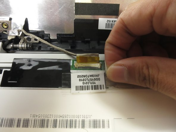

  7. HP Chromebook 11 G4 LCD Replacement: crwdns2935265:07crwdnd2935265:01crwdnd2935265:03crwdne2935265:0 HP Chromebook 11 G4 LCD Replacement: crwdns2935265:07crwdnd2935265:02crwdnd2935265:03crwdne2935265:0 HP Chromebook 11 G4 LCD Replacement: crwdns2935265:07crwdnd2935265:03crwdnd2935265:03crwdne2935265:0

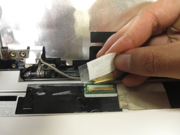

    • Peel off the clear sticker covering the display cable at the base of the LCD.
    • Gently pull the display cable from the connector.
