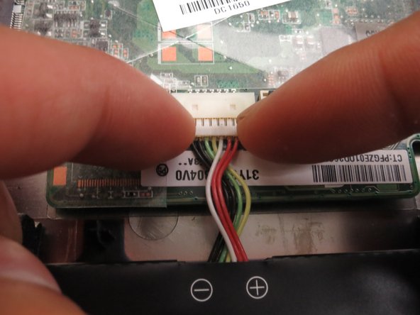

  10. HP Chromebook 11 G4 Battery Replacement: crwdns2935265:010crwdnd2935265:01crwdnd2935265:02crwdne2935265:0 HP Chromebook 11 G4 Battery Replacement: crwdns2935265:010crwdnd2935265:02crwdnd2935265:02crwdne2935265:0
    • Disconnect the bundled power cable by grasping both edges with your fingers and pulling.
  11. HP Chromebook 11 G4 Battery Replacement: crwdns2935265:011crwdnd2935265:01crwdnd2935265:01crwdne2935265:0
    • Lift the battery out of the laptop.
