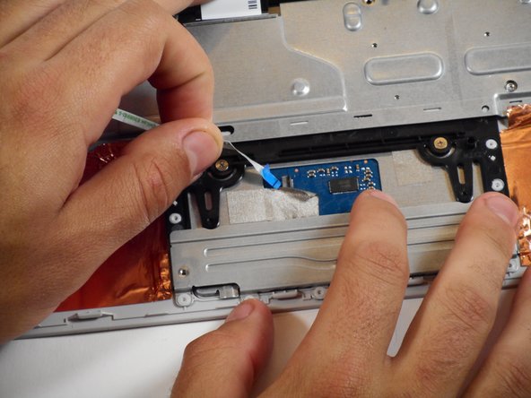

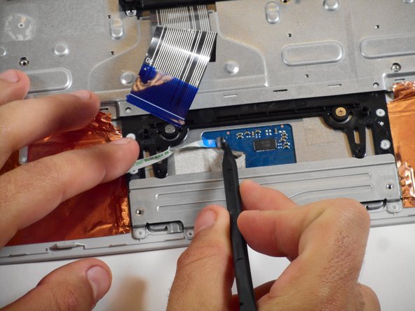

    • Flip the keyboard mount upside down.
    • Use tweezers to lift the tape on the bottom of the touchpad to expose the connector.
    • With a spudger, push up the ZIF retaining flip.
    • Pull out the small ribbon cable.

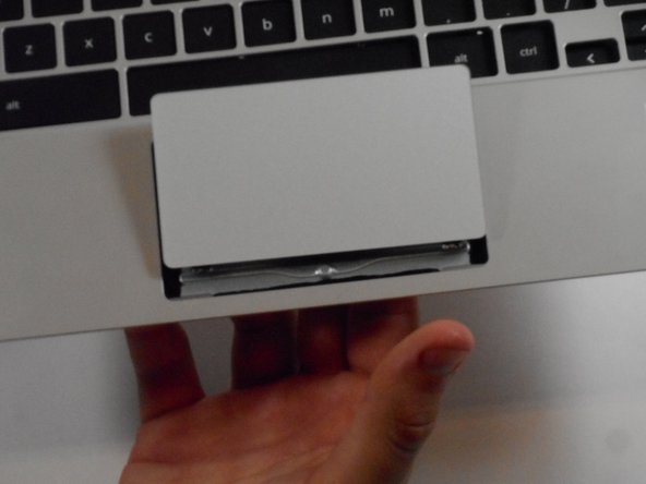

    • Remove the two Phillips #00 2mm screws that secure the touchpad to the black plastic housing.
    • Flip the keyboard mount to the upright position.
    • From beneath, push the touchpad up through the top of the keyboard mount to remove it.
