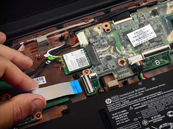

    • Use a spudger to lift the small ZIF retaining flap for the ribbon cable that connects the SD card reader to the motherboard.
    • Gently pull the cable out of its socket.

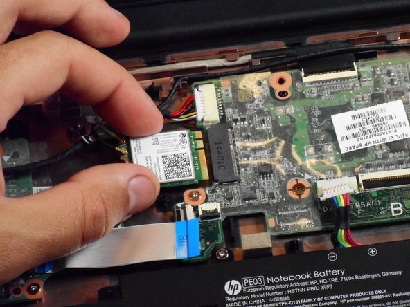

  8. HP Chromebook 11 G3 Motherboard Replacement: crwdns2935265:08crwdnd2935265:01crwdnd2935265:02crwdne2935265:0 HP Chromebook 11 G3 Motherboard Replacement: crwdns2935265:08crwdnd2935265:02crwdnd2935265:02crwdne2935265:0
    • Remove the 2 mm Phillips #00 screw that holds the Wi-Fi module in place.
    • Slide the Wi-Fi module out of the motherboard.
    • If the black and white cables come off of the Wi-Fi module, remember to reattach them during reassembly by matching the number on the wire to the number on the module.

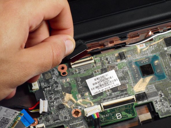

  10. HP Chromebook 11 G3 Motherboard Replacement: crwdns2935265:010crwdnd2935265:01crwdnd2935265:02crwdne2935265:0 HP Chromebook 11 G3 Motherboard Replacement: crwdns2935265:010crwdnd2935265:02crwdnd2935265:02crwdne2935265:0
    • Use a spudger to lift the small ZIF retaining flip for the ribbon cable that connects the display to the motherboard.
    • This cable comes out of the left side of the display’s hinge.
