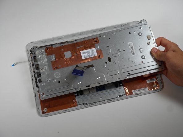

    • Lift the keyboard mount out of the laptop.
  6. HP Chromebook 11 G3 Keyboard Replacement, Keyboard: crwdns2935265:06crwdnd2935265:01crwdnd2935265:02crwdne2935265:0 HP Chromebook 11 G3 Keyboard Replacement, Keyboard: crwdns2935265:06crwdnd2935265:02crwdnd2935265:02crwdne2935265:0
    • Flip the keyboard mount upside-down.

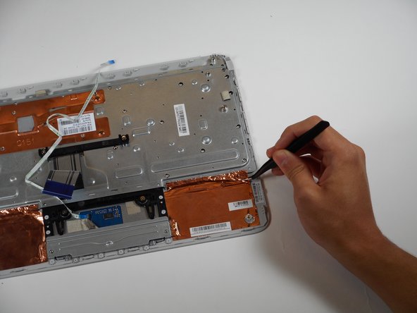

    • Using tweezers, peel off the two pieces of copper tape that keep the keyboard’s metal cover attached to the keyboard mount.

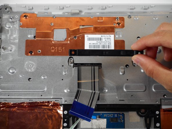

    • Remove the two 4 mm Phillips #00 screws located on either side of the horizontal black fastener located directly above the touchpad.
    • Lift the horizontal black fastener.

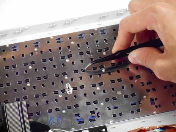

    • If only certain keys need replacement, stop here. Instead, use tweezers to remove individual keys by loosening their four snap-on clips from the metal backing.

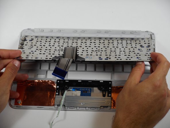

    • Use a plastic opening tool to disconnect the keyboard from the keyboard mount by prying along the keyboard’s perimeter.
    • Lots of adhesive attaches the keyboard to the keyboard mount. Loud snapping noises and gray, circular plastic debris are common during adhesive removal.
    • After removing enough adhesive, remove the keyboard’s backing.
    • Apply adhesive during reassembly to fasten the keyboard and its metal backing onto the keyboard mount.
