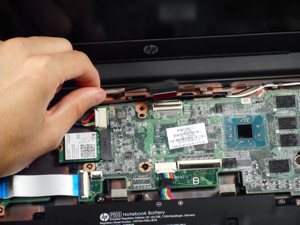

  6. HP Chromebook 11 G3 Display Assembly Replacement, Display Assembly: crwdns2935265:06crwdnd2935265:01crwdnd2935265:01crwdne2935265:0
    • Gently tug on the black and white wires connected to the Wi-Fi module to disconnect them.
  7. HP Chromebook 11 G3 Display Assembly Replacement: crwdns2935265:07crwdnd2935265:01crwdnd2935265:02crwdne2935265:0 HP Chromebook 11 G3 Display Assembly Replacement: crwdns2935265:07crwdnd2935265:02crwdnd2935265:02crwdne2935265:0
    • Using a spudger, lift the ZIF retaining flap that secures the display’s ribbon cable to the motherboard.
    • Gently pull the ribbon cable out of its socket.
  8. HP Chromebook 11 G3 Display Assembly Replacement: crwdns2935265:08crwdnd2935265:01crwdnd2935265:01crwdne2935265:0
    • Free the wire from the casing.
