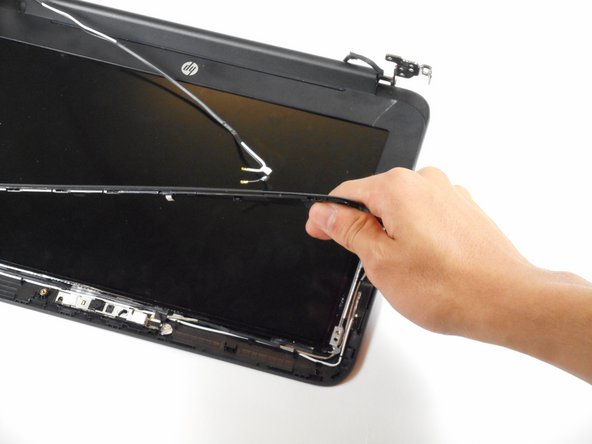

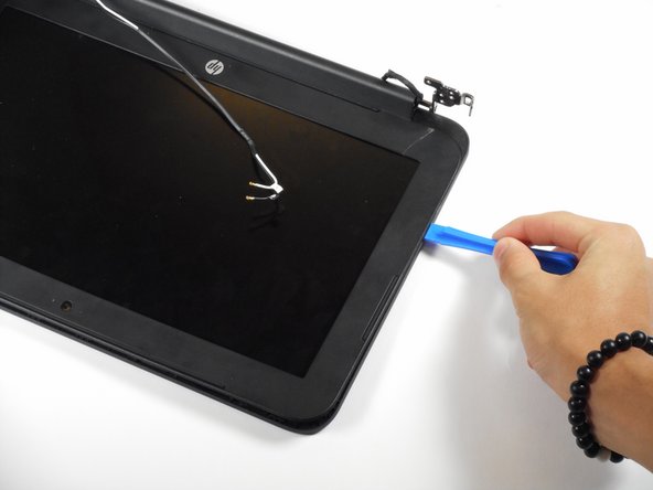

    1. HP Chromebook 11 G3 Camera Replacement, Screen Bezel: crwdns2935265:011crwdnd2935265:01crwdnd2935265:03crwdne2935265:0 HP Chromebook 11 G3 Camera Replacement, Screen Bezel: crwdns2935265:011crwdnd2935265:02crwdnd2935265:03crwdne2935265:0 HP Chromebook 11 G3 Camera Replacement, Screen Bezel: crwdns2935265:011crwdnd2935265:03crwdnd2935265:03crwdne2935265:0
      • Use the plastic opening tool to pry the left and right side of the top of the lid, and proceed inwards from the sides.
      • Do not attempt to remove the entire frame; this isn't necessary for removing the camera.
      • Do not pry at the center of the lid; this may damage the camera inside.
