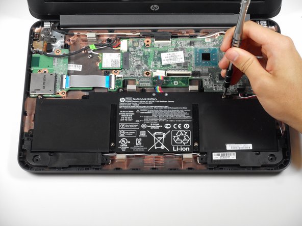

  6. HP Chromebook 11 G3 Battery Replacement, Battery: crwdns2935265:06crwdnd2935265:01crwdnd2935265:01crwdne2935265:0
    • Gently remove the battery’s rainbow-colored bundled cable from the motherboard.
  7. HP Chromebook 11 G3 Battery Replacement: crwdns2935265:07crwdnd2935265:01crwdnd2935265:02crwdne2935265:0 HP Chromebook 11 G3 Battery Replacement: crwdns2935265:07crwdnd2935265:02crwdnd2935265:02crwdne2935265:0
    • Remove the six 4 mm Phillips #00 screws located along the perimeter of the battery.
  8. HP Chromebook 11 G3 Battery Replacement: crwdns2935265:08crwdnd2935265:01crwdnd2935265:01crwdne2935265:0
    • Lift out the battery.
    • The laptop may tip backwards onto its lid due to uneven weight distribution.
