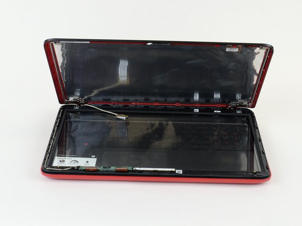

  1. HP Beats Special Edition 15-p390nr Screen  Replacement, Screen: crwdns2935265:01crwdnd2935265:01crwdnd2935265:01crwdne2935265:0
    • Use metal spudger to pry the screen from the back panel.
    • Popping sounds are normal
    • Make sure device is turned off
  2. HP Beats Special Edition 15-p390nr Screen  Replacement: crwdns2935265:02crwdnd2935265:01crwdnd2935265:01crwdne2935265:0
    • Use the Phillips #0 screwdriver to remove the four screws around the screen.
  3. HP Beats Special Edition 15-p390nr Screen  Replacement: crwdns2935265:03crwdnd2935265:01crwdnd2935265:02crwdne2935265:0 HP Beats Special Edition 15-p390nr Screen  Replacement: crwdns2935265:03crwdnd2935265:02crwdnd2935265:02crwdne2935265:0
    • Unclip wire from the screen and lift screen to remove.
