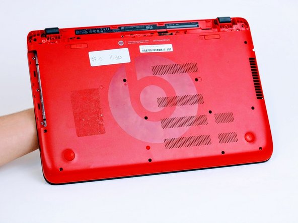

    • Turn computer off before starting.
    • Turn computer over and begin removing noticeable 8mm screws with a Phillips #0 screwdriver.
  2. HP Beats Special Edition 15-p390nr Fan Replacement: crwdns2935265:02crwdnd2935265:01crwdnd2935265:02crwdne2935265:0 HP Beats Special Edition 15-p390nr Fan Replacement: crwdns2935265:02crwdnd2935265:02crwdnd2935265:02crwdne2935265:0

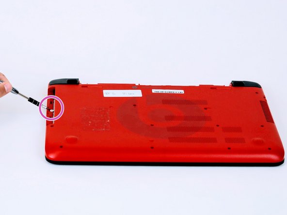

    • Once screws are removed you may now remove the optical drive.
    • Remove the hidden 3mm screw in the optical drive port.

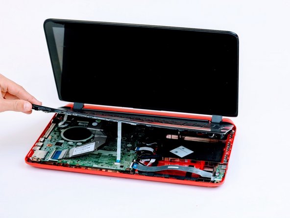

    • Flip computer over and wedge metal spudger along the computer to pop off keyboard panel
  6. HP Beats Special Edition 15-p390nr Fan Replacement: crwdns2935265:06crwdnd2935265:01crwdnd2935265:02crwdne2935265:0 HP Beats Special Edition 15-p390nr Fan Replacement: crwdns2935265:06crwdnd2935265:02crwdnd2935265:02crwdne2935265:0
    • Unclip wires connected to the motherboard and remove keyboard from the device.
    • 17 screws should be removed up to this point.

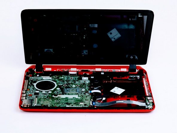

  7. HP Beats Special Edition 15-p390nr Fan Replacement, Motherboard: crwdns2935265:07crwdnd2935265:01crwdnd2935265:01crwdne2935265:0
    • Remove screws from the motherboard.
    • 11 screws should be removed from the motherboard
  8. HP Beats Special Edition 15-p390nr Fan Replacement: crwdns2935265:08crwdnd2935265:01crwdnd2935265:01crwdne2935265:0
    • Unclamp wire strips from motherboard.
  9. HP Beats Special Edition 15-p390nr Fan Replacement: crwdns2935265:09crwdnd2935265:01crwdnd2935265:01crwdne2935265:0
    • Detach by lifting the motherboard up and flip the motherboard over.
