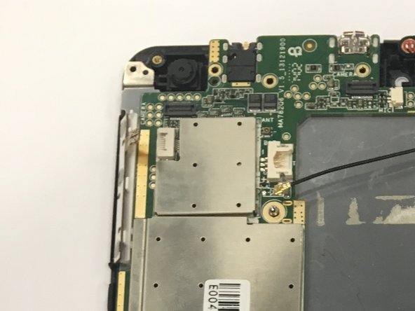

  4. HP 8 1401 Power/ Volume Button Board Replacement, Power/ Volume Button Board: crwdns2935265:04crwdnd2935265:01crwdnd2935265:03crwdne2935265:0 HP 8 1401 Power/ Volume Button Board Replacement, Power/ Volume Button Board: crwdns2935265:04crwdnd2935265:02crwdnd2935265:03crwdne2935265:0 HP 8 1401 Power/ Volume Button Board Replacement, Power/ Volume Button Board: crwdns2935265:04crwdnd2935265:03crwdnd2935265:03crwdne2935265:0
    • Disconnect the power/ volume button board from the control board by pulling the ribbon cable out of the white connector. You can use tweezers or your fingers.

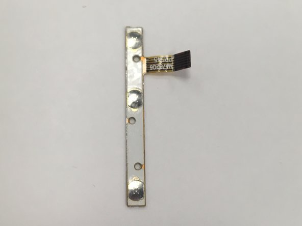

  5. HP 8 1401 Power/ Volume Button Board Replacement: crwdns2935265:05crwdnd2935265:01crwdnd2935265:01crwdne2935265:0
    • After removing the power/ volume button board, it should look like this.
