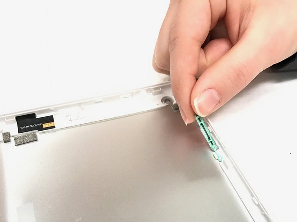

  4. HP 7 Plus 1302 Power and Volume Button Replacement, Power and Volume Button: crwdns2935265:04crwdnd2935265:01crwdnd2935265:01crwdne2935265:0
    • Locate the power and volume buttons on the right side
  5. HP 7 Plus 1302 Power and Volume Button Replacement: crwdns2935265:05crwdnd2935265:01crwdnd2935265:02crwdne2935265:0 HP 7 Plus 1302 Power and Volume Button Replacement: crwdns2935265:05crwdnd2935265:02crwdnd2935265:02crwdne2935265:0
    • Pop out the power and volume buttons with your hands
