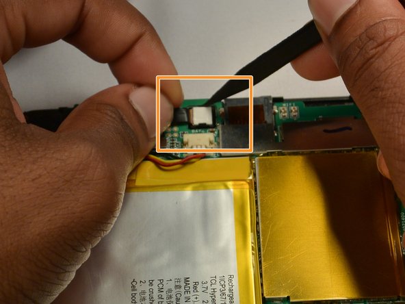

  4. HP 7 Plus 1302 Camera Replacement, Front and Rear Facing Cameras: crwdns2935265:04crwdnd2935265:01crwdnd2935265:01crwdne2935265:0
    • The cameras are connected together via a small ribbon cable with one electrical connection in between them.
    • Locate the small grey connector near the top of the device. Using the Spudger tool, gently pull it away from the device until it releases its connection.
    • This will come out very easily so don't use much force.
