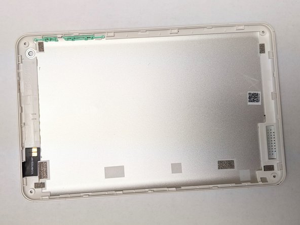

  4. HP 7 PLUS 1301 Volume / Power Button  Replacement: crwdns2935265:04crwdnd2935265:01crwdnd2935265:01crwdne2935265:0
    • The power and volume buttons are on the side of the device. Locate these buttons to begin the replacement process.

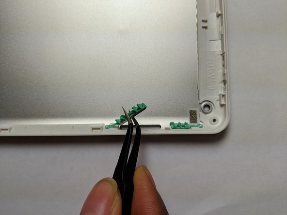

  5. HP 7 PLUS 1301 Volume / Power Button  Replacement: crwdns2935265:05crwdnd2935265:01crwdnd2935265:02crwdne2935265:0 HP 7 PLUS 1301 Volume / Power Button  Replacement: crwdns2935265:05crwdnd2935265:02crwdnd2935265:02crwdne2935265:0
    • Gently push out the power and volume buttons with tweezers.
