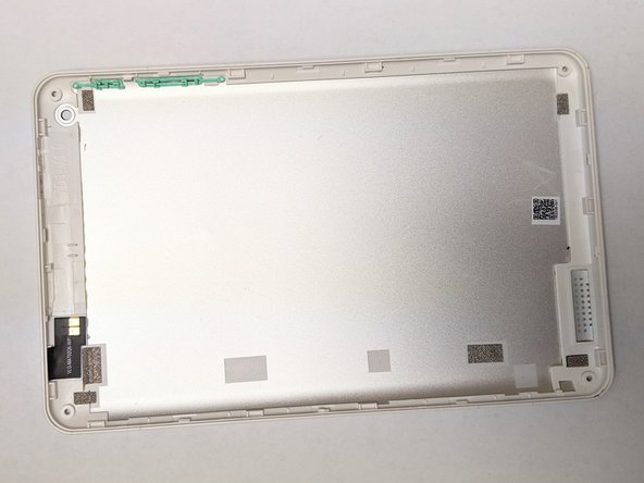

  2. HP 7 PLUS 1301 Speaker Replacement: crwdns2935265:02crwdnd2935265:01crwdnd2935265:02crwdne2935265:0 HP 7 PLUS 1301 Speaker Replacement: crwdns2935265:02crwdnd2935265:02crwdnd2935265:02crwdne2935265:0
    • Using the plastic opening tool, push in between the front, then slide it around.
    • Slide the plastic opening tool all the way around the tablet to separate the back cover.
    • Be careful when trying to remove the back as the screen can be damaged with excessive force.
  3. HP 7 PLUS 1301 Speaker Replacement: crwdns2935265:03crwdnd2935265:01crwdnd2935265:02crwdne2935265:0 HP 7 PLUS 1301 Speaker Replacement: crwdns2935265:03crwdnd2935265:02crwdnd2935265:02crwdne2935265:0
    • Continue sliding the plastic opening tool around the tablet until the cover fully separates from the device.
    • Remove the back cover.

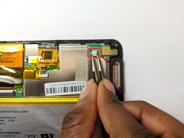

  4. HP 7 PLUS 1301 Speaker Replacement: crwdns2935265:04crwdnd2935265:01crwdnd2935265:02crwdne2935265:0 HP 7 PLUS 1301 Speaker Replacement: crwdns2935265:04crwdnd2935265:02crwdnd2935265:02crwdne2935265:0
    • Using tweezers, carefully remove the speaker connector from the socket.

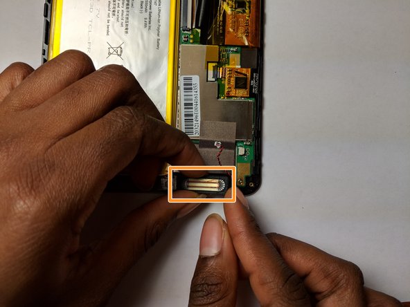

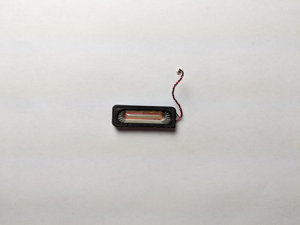

  5. HP 7 PLUS 1301 Speaker Replacement: crwdns2935265:05crwdnd2935265:01crwdnd2935265:03crwdne2935265:0 HP 7 PLUS 1301 Speaker Replacement: crwdns2935265:05crwdnd2935265:02crwdnd2935265:03crwdne2935265:0 HP 7 PLUS 1301 Speaker Replacement: crwdns2935265:05crwdnd2935265:03crwdnd2935265:03crwdne2935265:0
    • Insert a spudger in the bottom right of the speaker. It makes the speaker easier to come off.
    • Carefully remove the speaker with your hand.
    • Some force needs to be applied here due to the adhesive on the other side of the speaker.
