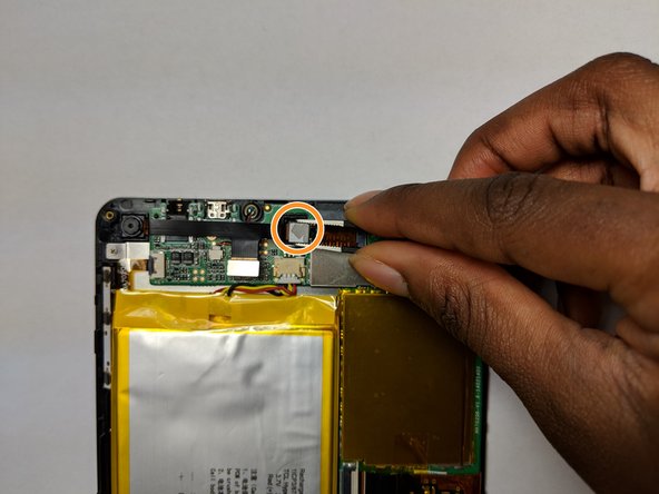

    • Locate the front and rear cameras.
  5. HP 7 PLUS 1301 Front and Back Camera Replacement: crwdns2935265:05crwdnd2935265:01crwdnd2935265:02crwdne2935265:0 HP 7 PLUS 1301 Front and Back Camera Replacement: crwdns2935265:05crwdnd2935265:02crwdnd2935265:02crwdne2935265:0

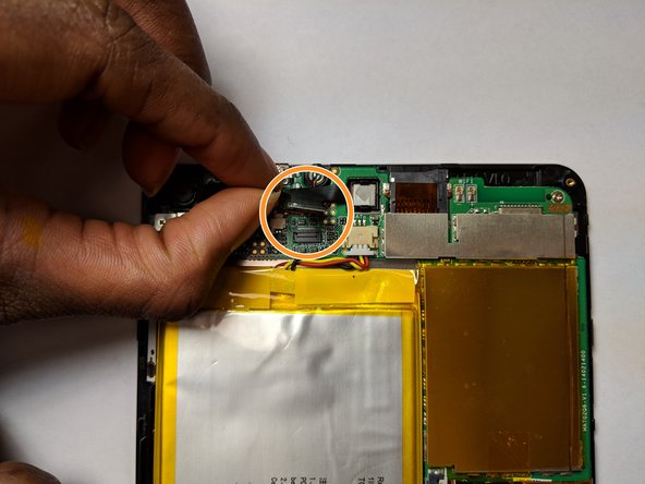

    • Using the opening tool, locate the rectangular gray connector near the camera and gently release its connection.
    • Lift the connector out and away from the board.
    • This will come out very easily so don't use much force.

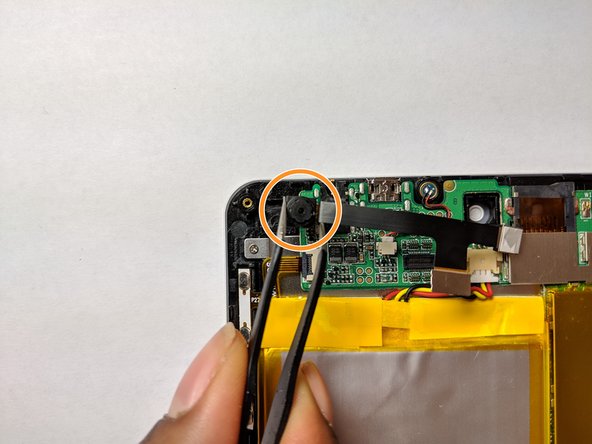

    • Gently push the tabs on both sides until the front camera is loose.
    • Using your blunt tweezers, lift the front camera gently away from the board.

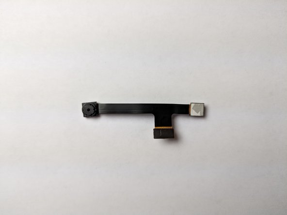

  7. HP 7 PLUS 1301 Front and Back Camera Replacement: crwdns2935265:07crwdnd2935265:01crwdnd2935265:03crwdne2935265:0 HP 7 PLUS 1301 Front and Back Camera Replacement: crwdns2935265:07crwdnd2935265:02crwdnd2935265:03crwdne2935265:0 HP 7 PLUS 1301 Front and Back Camera Replacement: crwdns2935265:07crwdnd2935265:03crwdnd2935265:03crwdne2935265:0
    • Using your angled tweezers, gently pry out the back camera.
    • The camera is held down with tape.
    • Lift the back camera out of its socket and gently pull out both cameras.
