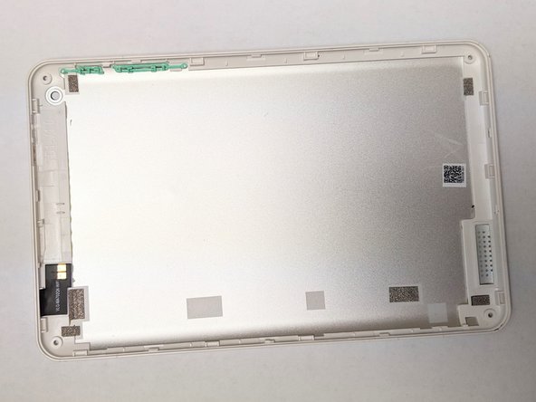

  3. HP 7 PLUS 1301 Battery Replacement: crwdns2935265:03crwdnd2935265:01crwdnd2935265:02crwdne2935265:0 HP 7 PLUS 1301 Battery Replacement: crwdns2935265:03crwdnd2935265:02crwdnd2935265:02crwdne2935265:0
    • Continue sliding the plastic opening tool around the tablet until the cover fully separates from the device.
    • Remove the back cover.

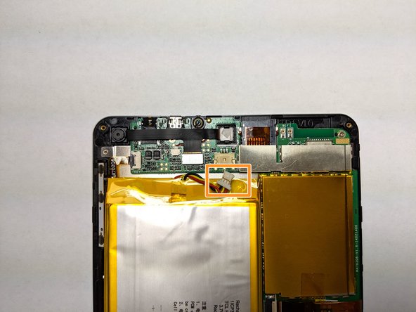

  4. HP 7 PLUS 1301 Battery Replacement: crwdns2935265:04crwdnd2935265:01crwdnd2935265:02crwdne2935265:0 HP 7 PLUS 1301 Battery Replacement: crwdns2935265:04crwdnd2935265:02crwdnd2935265:02crwdne2935265:0
    • Push out the connector to disconnect the battery.
    • Move the battery connector clear of the connector socket.
  5. HP 7 PLUS 1301 Battery Replacement: crwdns2935265:05crwdnd2935265:01crwdnd2935265:01crwdne2935265:0
    • Carefully remove the battery by sliding a plastic spudger under the battery. Use an adhesive remover if available under the battery to make it easier for the battery to come off.
